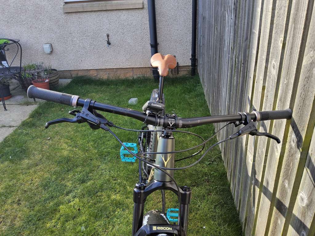

take a pic of your bike when in a sitting on it position, close up of bars area, then same with a slightly lower view say, camera by saddle facing towards bars.
Posted : 04/03/2024 11:18 am
Posts: 31788
OP, I think you're on the right path... no excess steerer means try higher rise bars... BUT use your existing bars to get the width right first... you might even find that cut down, with your hands less far apart, that the height works with the low rise.

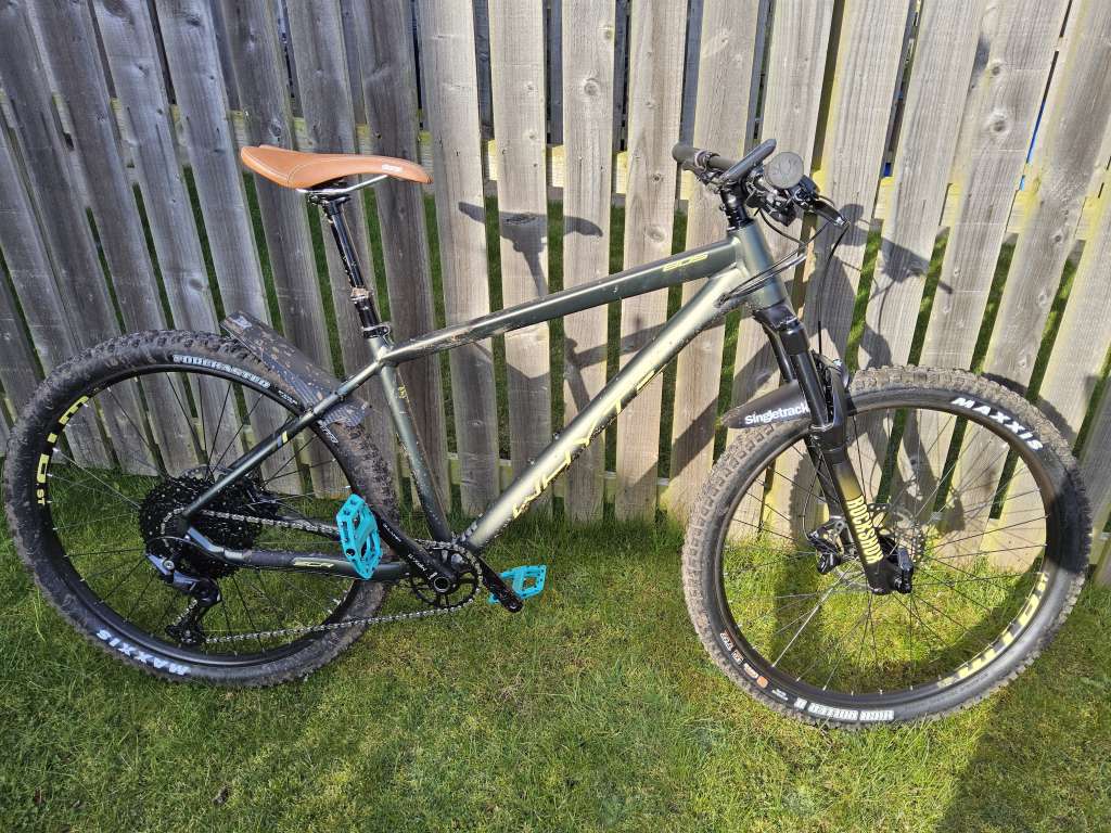

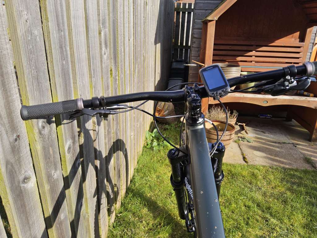

20240304_14351620240304_14352920240304_143507

That Whyte is a loooooong bike - that's your first problem. You might never get it feeling quite how you like it without downsizing
Definitely try some higher bars though
