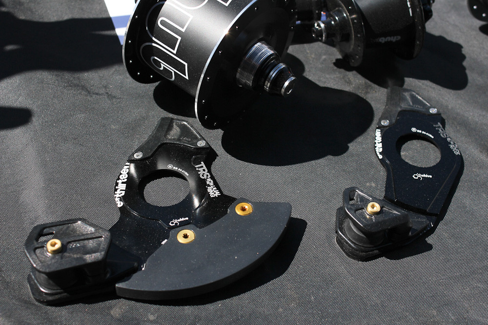

something like the e-13 TRS?
[img] ?1334938728[/img]
or a blackspire stinger
