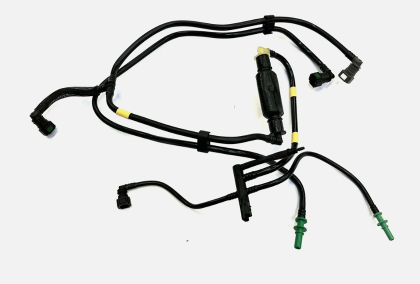

Posts: 3675
Not 100%, but don't think it has a tank lift pump, just sucked through from the tank by the main pump - hence why they are so susceptible to any air leaks that then show up as pressure faults.
Our pinhole air being sucked in issue occured 5 hours and 400km into an Autobahn journey and died alarming as you describe with a fuel pressure fault code. German dealer didn't find the real fault and tried changing the fuel filter and it got us to Sweden then all the way back home to UK with no further issue. It was only when I did a precautionary fuel filter change back home that I hear it sucking air when I squeezed the fuel priming bulb.
I'm not saying this is definitely your issue, but get it properly checked out before throwing pumps and labour at it.

Posts: 488
My Dispatch had an air leak on the Diesel priming bulb. You couldn't buy just the bulb and the whole thing was really expensive. As a work around I put a bicycle puncture patch on it and it was still fine 5 years later. Weird symptoms. Would run fine but then wouldn't start easily when hot. Noticed air bubbles in the fuel line and traced it back to the bulb. I was lucky it was so easy to find though.

Posts: 3675
Ratty -  could quite well be wrong on the lift pump, and that would be a cheap and easy fix. But you definitely have this nest of plastic pipes and primer bulb on top of the engine (plus the cooler you mentioned underneath). Any leak in that lot can cause pressure issues.
Lad's 05 Berlingo, our previous 08 Dispatch and Mrs' 10 C3 Picasso all have the squeezy priming bulb shown below (All 1.6 HDI). Not sure if dad's 1.6 HDI by another name Focus has the priming bulb.

Posts: 39914
well you had me curious-
turns out we are both simultaneously wrong and both right .
 if you have the bosch hdi system there's no primer but there is a lift pump - i know my engine bay like the back of my hand and id be surprised if they snuck that in on me.
IF you have a siemens HDI system theres a primer and no lift pump.
on the 8v engines 2010-2015 it comes down to if you have 75/92 bhp or 112-115bhp.
the lower ~BHP get the bosch system and the higher ones get the siemens
so to the OP if you have a 112 or 115bhp berlingo - id be checking out that primer bulb first port of call.
