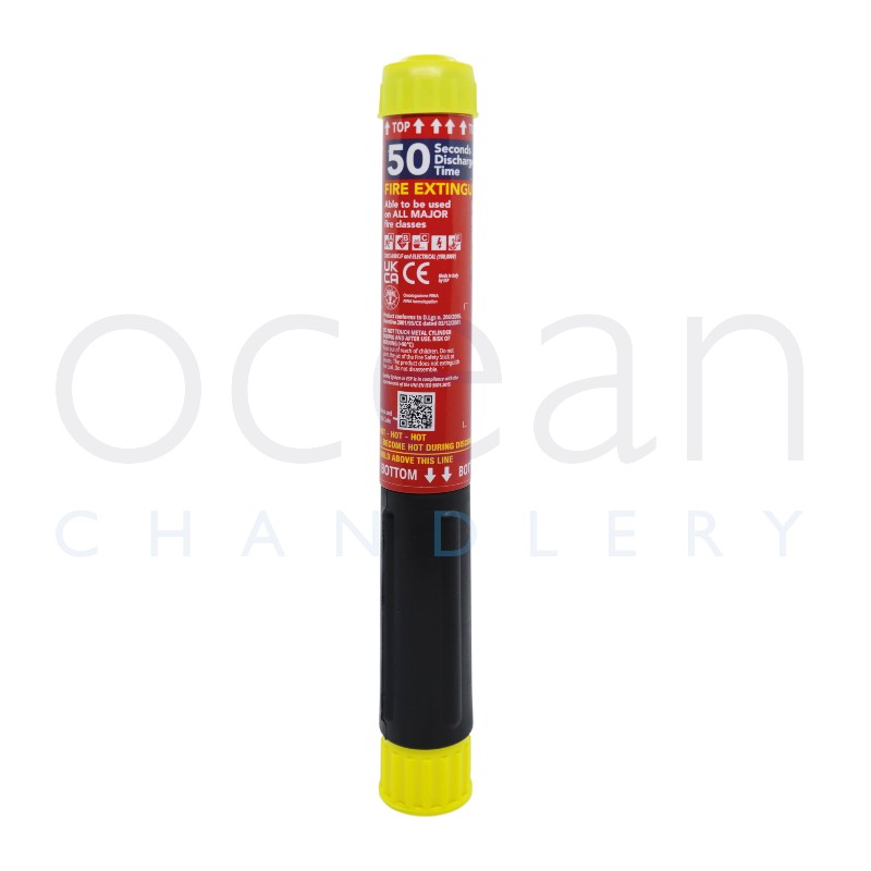

I've got one of these Fire Safety sticks:
https://www.oceanchandlery.com/fire-safety-stick.html
Uses a Potassium powder jet. Seemed a good option to me Light, long lasting, less mess and long expiry date. Thankfully no real life experience.
IIRC that should be good to use on nuclear fuel as well.

Those potassium sticks - they consume all the oxygen, instead of the fire doing so. Doesn’t this risk asphyxiation in a van, if you’ve not already opened the door and GTFO?
Posted : 15/04/2022 12:04 am
I’ve got a 1kg powder. Also a CO monitor. It may not be ideal in all circumstances but the fact you’re even asking the question suggests you’re ahead of a good proportion of the van population!
My youngest managed to set off the one in my ex army Land Rover. Yes it does make a hell of a mess, and the powder is so fine it gets everywhere, which I suppose is the point. It’s also highly corrosive as I found out when my lights stopped working. After changing loads of bulbs I found it was due to the internal contacts completely corroding away, after less than 12 months.
If vans on fire though I wouldn’t hesitate!
Posted : 15/04/2022 11:04 am
Presumably for something that consumes the oxygen, you get out, activate and throw it in and shut the door.
