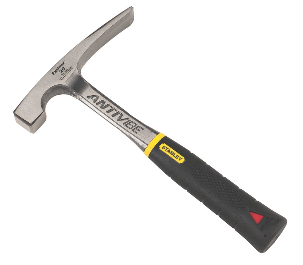

This is what you need....
[img] http://images.littlewoods.com/is/image/Littlewoods/A111P_SP711_93_UC0FP [/img]
DrP
(got the second one for my lad for christmas!!)

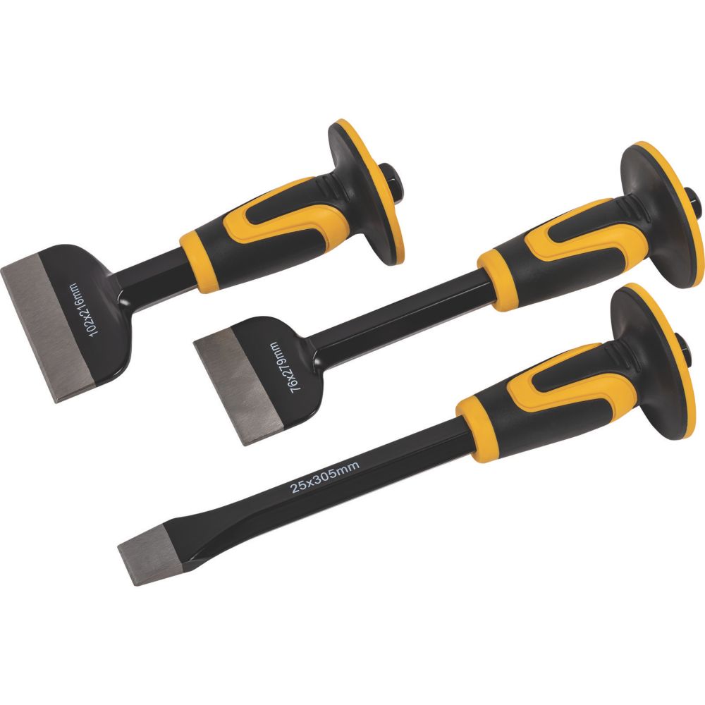

I reckon you'll have that lot, down, cleaned, and in neat piles in half the time it's taken him to put them up 🙂
[img] http://s7g3.scene7.com/is/image/ae235?$p$&layer=0&size=281,281&layer=1&size=281,281&src=ae235/80060_P [/img]
[img] http://s7g3.scene7.com/is/image/ae235?$p$&layer=0&size=281,281&layer=1&size=281,281&src=ae235/46209_P [/img]

Scutching hammer

The mortar on the blocks won't be fully set so it should knock off quite easily with a trowel, you could probably get away with knocking bits of it down to get the piers bonded in again.
