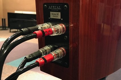

Was going to say, it'll be to do with Bi-Amping, so instead of stereo (L-/L+) & (R-/R+) cables found on cheaper systems, they are saperated for bass and trebble
So on the left channel you have
Hi+ cable
Hi- cable
For the treble ON EACH speaker
And for the Bass on EACH speaker, another two wires
Low+ cable
Low- cable
So you'd have 8 seperate audio cables feeding two cabinates ( 4 each)
https://www.audioadvice.com/videos-reviews/speaker-bi-wiring-bi-amping-explained

Equally, if the amp is more 'standard', but you have bi-wirable speakers, the speakers should have removable bridge plates for the hi/lo +/- terminals
bridge
Posted : 02/12/2023 11:33 pm
