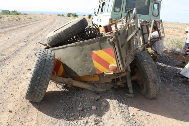

McMoonter's log trolley on Saturday
[img] http://forum.ih8mud.com/attachment.php?attachmentid=644100&stc=1&d=1339641034 [/img]
Posted : 26/06/2013 9:20 am
