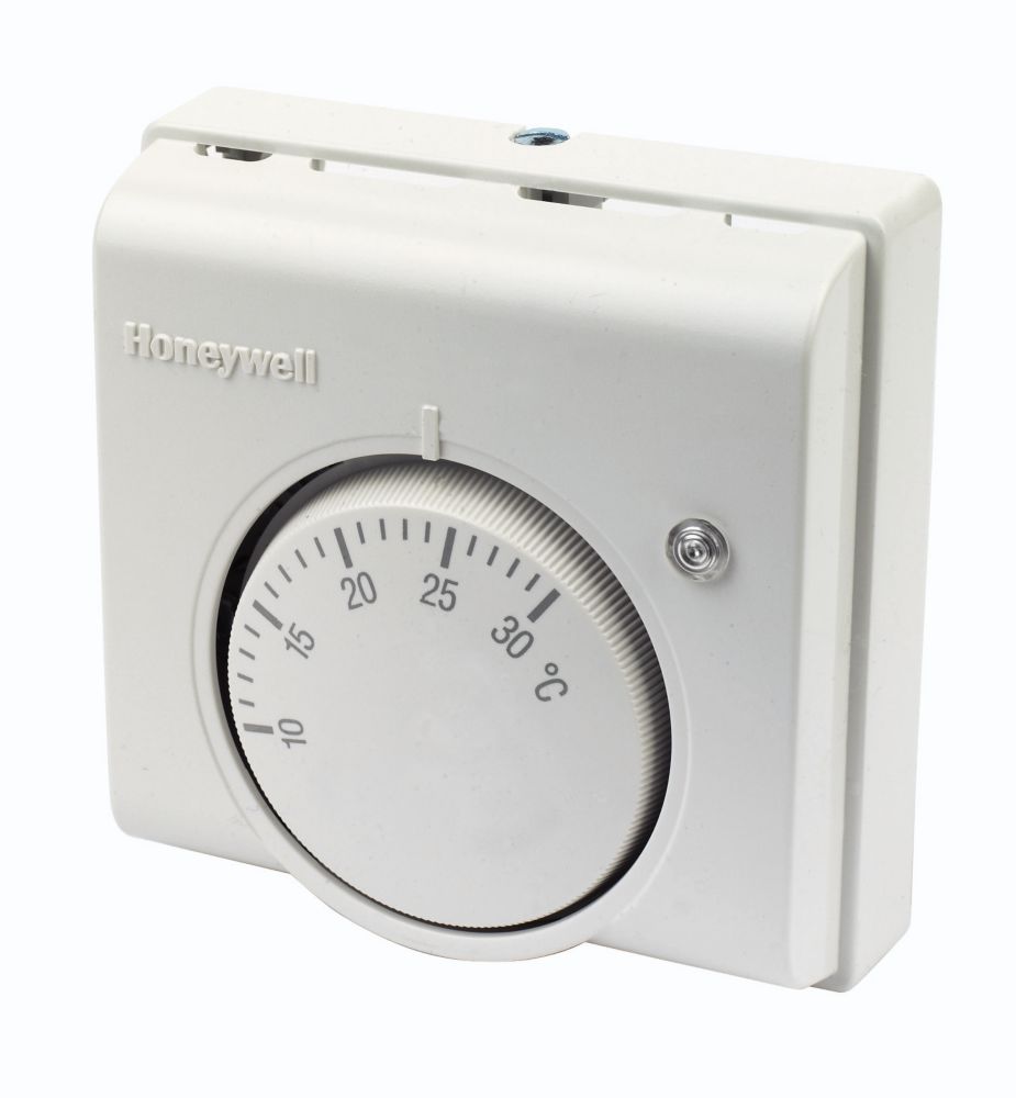

When you say mains powered do you mean one like this?
[img] http://s7g3.scene7.com/is/image//ae235?src=ae235/26159_P&$prodImageMedium$ [/img]
If so you should be able to fit something like [url= http://www.salus-tech.com/products/rf-thermostats/rt500rf/ ]this RT500RF[/url], its battery powered
Salas have a range of normal and internet connected thermostats

grahamA,
yes, thats the type, in fact its those ones exactly
