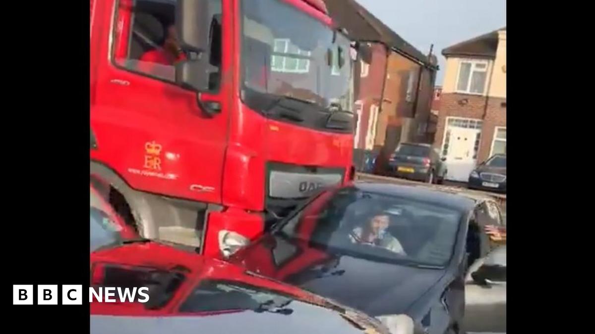

BBC linky
Can any truckers confirm this a plausible event? A friend of mine is a RM HGV driver, hes working at the moment but I'll ask him later.
And this actually happened to his daughter. Truck pulled up behind her corsa at lights, very close, forgot she was there apparently, pushed her 300m along the road before he realised.
Extra scary if you think of bikes in close proximity to hgvs.

I've seen this happen before, on the m25 some years ago. As I drove past in lane three, I saw the car in lane two waving madly at the trucker who had a car in front just like that.

That link wasn't working for me, but Googled and found it:
https://www.bbc.co.uk/news/uk-england-london-50819996
Of course, at the end, "Police say no crime was committed"

clearly the Golf driver's error. no sign of hi viz anywhere and neither of them were wearing helmets.

Sit in any car and take your time to look at what you can't see, put objects in front of it, then scale it up to truck proportions and you see how you can lose an entire car.
Posted : 17/12/2019 3:19 pm
Posts: 13622
Ignoring the sight here, would the driver not notice the change in how the truck drove? Surely he'd be needing more power to accelerate and would have noticed that?

As a hgv driver there's no excuse to not see that and yes he would most definitely feel the resistance of pushing a car along.
Every truck has a down facing mirror that shows anything immediately in front of you... Its there to spot pedestrians and cyclists that pop up in front of you at traffic lights etc when stationary... Its an offence to not have it set up correctly as far as I'm aware.
If he doesn't get the sack I'll be surprised
Posted : 17/12/2019 3:59 pm

Transporter thanks, reassuring to know that's a thing! Do you think its effective though?

I've wondered if the driver would feel the resistance, must be quite a lot from pushing around a 1.5-2 tonne metal box with rubber feet but then maybe the extra power on hand (if the HGV was empty) means you can't? Would have thought there'd be a smell of burning rubber and noise to.
Then again shortly after I passed my test I drove my car a few miles with the handbrake on thinking it just felt a bit sluggish so I'm not one to criticise :p

Most definitely effective.. We're taught to check all our mirrors at least every 10 seconds when training.. Now even if you let that lapse there's no excuse imo to jot know he was there...
The guy in the golf is actually an employee of car throttle which makes videos on YouTube so some good could come from this... If they are savvy then they could get together with royal mail and seize the opportunity to show how dangerous trucks can be
yup, if you look carefully at the video you can see he has one. clearly not using it though.

Truck mirrors are amazingly good compared with car mirrors, you can see everything except what is immediately behind you whilst driving forwards as per transporter13 this is deliberately not looking , a damaged mirror would be a fix before work and extra caution driving to get it fixed.

I wondered whether you'd notice it or not. HGV's are pretty noisy, and as others said it's pretty easy to drive a car with the handbrake on and only prercieve it as a bit sluggish, the throttle isn't like pedaling a bike where even a slightly rubbing brake makes itself felt. I imagine 20 tons (or it's absence) of stuff in the back probably makes more difference.

I drive a bus, which is a bit lighter than a truck (fully loaded, including trailer, hitting c24tons)
Could it pull/push a car without noticing extra throttle? Yes, easily.
Do I believe for a second that it would actually happen at the front of the vehicle? No, you would hear it.
I have been a passenger in a town bus (only 9 tons) that rear ended a car, i barely felt it, but I certainly heard it.

As a hgv driver there’s no excuse to not see that and yes he would most definitely feel the resistance of pushing a car along.
Every truck has a down facing mirror that shows anything immediately in front of you… Its there to spot pedestrians and cyclists that pop up in front of you at traffic lights etc when stationary…
I drive a Daf CF almost identical to the one involved. If he was on cruise control then this would detect a slight drop in speed and increase the power automatically. As quoted above regarding the mirror Its there to spot pedestrians and cyclists that pop up in front of you at traffic lights etc when stationary…..... I can see no reason why a driver would even consider looking in this mirror at 40 mph in what he considered to be normal circumstances. Loud music in the cab could mask the noise of the tyres screeching. As shown in picture, it's quite feasible that the car was below his eye-line. If you look at other sideswipe videos like this they often occur very slowly so there might not be much of an impact to feel. null

transporter13 is mostly right about the driver should have noticed the extra drag. In that size of truck the extra tonne or so should be noticeable but it could be easy enough to miss if it has a torquey engine. Anything larger and the percentage change in weight gets less so it's easier to not notice immediately. We had a gentle reminder given to the HGV drivers in work this morning about this as we've had 2 of these incidents as a company in the last year. I've seen the on-board CCTV of one of them involving a Mercedes Axor that was loaded up to 24 tonnes. It collected a Fiat 500 that turned across it in traffic and, as switchbacktrog says, there was barely any impact detectable from the cab. It was also small enough to be well below the sight line of the driver, even the cameras had a tough time seeing it and they're mounted higher up than the driver sits! The truck was doing 65 kph at the time and the tacho trace shows a drop of 1kph at the time, for an idea of how little this is it showed a bigger drop in speed over a rough patch of road shortly before. When the Smart ForTwo first came out there were a few instances of drivers not seeing them and pushing them forward at traffic lights! There was also on instance in rural France of a driver driving out of a rest area and pushing one of those microcars they have along and crushing it, thankfully it was empty. The owner had pulled in front of the truck in such a way that it was completely invisible from the cab. As they weigh 400kgs there was no weight to notice.
If you've never been in a truck cab on the road I suggest you do if the opportunity arises. It's scary how little they can see and what can disappear in a blind spot, the mirrors do help but the driver can only look in one direction at a time. The one mentioned above that looks down the front of the cab is only really useful at walking speeds and is mainly to help with parking manoeuvres and spotting pedestrians and cyclists when stopped at traffic lights and junctions. Also the noise and vibrations inside the cabs on a lot of trucks are enough to give you a sensory overload the first time you experience it, either that or they're so well isolated from the outside that you can't hear much like when you switch on some noise cancelling headphones.. When you have experience of this you find yourself giving trucks much more space and consideration when near one, on foot, bike or in the car.

I'm afraid Ill have to disagree with you about the use of the front mirror.... Quite often in built up traffic you can have all lanes moving at differing speeds... If the nearside lane is moving slightly quicker then I tend to make a mental note of each car that is coming past.. As they can then sit in that blind spot for a good few seconds if the lane speed equalises slightly.. That mirror is there for this reason also as a last line of defence if you will so you can at least have a chance of seeing anything down there.
Now to say you wouldn't feel that at 40mph..ok maybe if you were pulling a trailer for instance but when you're bobtail?
And I'm pretty sure that if my window was open even a few inches like the drivers' was I'd be horrified if I couldn't hear a car scraping down the road near me regardless of what music I was listening to and how loud it was.
You might not see it in advance, but if something is attached to your front bumper would that not be visible regardless of speed?

OK when not driving forwards but turning the mirrors of an articulated truck can only show the operator what they are reflecting , they will always show the driven unit , but not the trailer when turning .

Is the front mirror wide angle or would it just look down at the dark section of car roof, looking like tarmac at a glance? I have no idea but in the freeze frame above, does the mirror look the right angle to see anything?
I was thinking similar. An unmoving patch of back that filled the mirror.

I've always thought that that video that Cougar posted seems to have a truck with very poorly adjusted mirrors. A large proportion of the mirror is filled with the truck cab. Surely they should be adjusted so that the cab is only just visible giving you the widest possible view? Would be interesting to see how many of those cyclists were still invisible if you did that.

The mirrors are pretty much the same as they were 20 years ago. If you make them too big it creates huge blind spots at junctions and roundabouts. This is a recognised issue which is why I always take a second glance before pulling out. Imagine if the "A" pillar in your car was 12" wide.......That's what HGV drivers have to take into account. Some of the latest Mercedes trucks have small cameras on stalks instead of mirrors with a screen mounted on the inside of the "A" pillar. The cameras swivel with the steering so you can keep the end of the trailer in sight on tight corners. The clip below shows it well.
