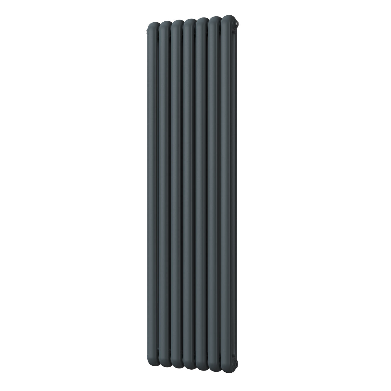

Hi,
Just thinking of moving our ancient radiator. The plumber has suggested that we swap them for something like this:
https://www.amazon.co.uk/Vertical-Designer-Radiator-Anthracite-Radiators/dp/B075JFTY9W/ref=sr_1_6
Vertical would suit our requirements because the horizontal is taking up too much space.
Anyone got anything like this?
Mick
Posted : 22/02/2021 11:03 am

Yep, have 3 in our lounge/kitchen/diner.
They are not always as efficient as the regular flat panel radiators - so check the BTU ratings of both options before you commit.
We have 3 in a 5m2 room and they sometimes struggle.

Posts: 21012
They are not always as efficient as the regular flat panel radiators – so check the BTU ratings of both options before you commit.
Very much this - we have some in our open plan kitchen diner and we struggle to get it warm enough unless we are cooking. In fact just last week I started to look at options for larger higher output replacements.

Posts: 39855
Look for column rads rather tha designer.
Designer box on most sites seems to give a bunch of nice looking but woeful performance rads.
The ones in bnq and Screwfix have crap BTUs for their size but look cheap till you get an appropriate sized btu one.
I have a tiny width 3 bar 5ft tall one in the kitchen and a 4 bar 5ft tall one in the dining room.and they cope with heating the 6mx7m with vaulted ceiling no bother ..... Thy are about double the BTUs of anything the same size from bnq/Screwfix thus avoiding the issue Johndoh has. Neither are in optimum location......mainly for room constraints.

Posts: 45104
On the BTU thing - yes the cheap ones are lower but IIRC some are close - alloy rather than steel?
But yes - be very careful to get one with enough BTUs

 poly
Posts: 9270
As a heater, it’s a compromise. Output aside, it’s in the corner of the room so very tucked away – the heat source is further away from parts of the room than a normal shaped one would be, and we can tell. I’d oversize it if I did it again. I’m tempted to swap out for a bigger one as it is.
I'm not sure that has anything to do with the "heater" its because you've put it somewhere stupid.
OP - have you thought about the weight of it and how it will be mounted to the wall? They are bloody heavy when empty never mind full. Modern plaster board walls weren't designed for 200kg to hang off... so you may need to do some engineering behind.

Posts: 16284
This +1. We specified poncey radiators in our rebuilt kitchen/ diner last year: I did a lot of research to find models with a decent BTU output as a lot of them are much lower than an equivalent standard radiator. Ours are made by Reina.

Posts: 21012
Anecdotally, we have a 'high output' towel radiator in our main bathroom - it is no bigger than any other radiator in the house but it is the only one that you can actually feel the heat radiating from - so I do think it is worth making sure you get performance radiators if you are concerned about them not heating the space.

Posts: 4628
OP – have you thought about the weight of it and how it will be mounted to the wall? They are bloody heavy when empty never mind full. Modern plaster board walls weren’t designed for 200kg to hang off… so you may need to do some engineering behind.
This is a good point. Ours was being mounted into a 'breezeblock' wall, and rawlplugs wouldnt hold it, we ended up using chemical bolts to fasten the radiator to the wall.

Posts: 1085
All my walls are brick.
Posted : 22/02/2021 12:41 pm

Posts: 1085
Maybe this then?:
https://ukradiators.com/sphera-anthracite-vertical-column-radiator-h1800mm-x-w507mm-2-column.html
Posted : 22/02/2021 12:42 pm
Posts: 198
Just redecorated my lounge which used to be the coldest room in the house. 3 outside walls and we used to sit with blankets on in the winter. Replaced the old radiators with a pair of these:
https://www.bestheating.com/milano-skye-anthracite-aluminium-vertical-designer-radiator-various-sizes-92489
It's now the warmest room in the house 🙂
As others have said, check the BTU rating as the size doesn't necessarily correlate with the output. I got aluminium ones which heat up quick and are lightweight so hang on a dot and dab wall with no issues.
The only problem I had was finding paint to match. I used the RAL code to get the same colour paint and it was way off. In the end I took a punt on a similar dulux trade colour and its bang on.

Posts: 3666
You can get "designer" ones with / without the convector fins on the back - on otherwise identical rads, just that one change makes a massive difference to the quoted output figures. Probably also need to check the fins are orientated correctly for vertical / horizontal installation.
