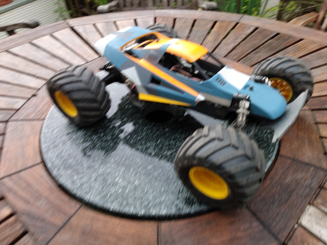

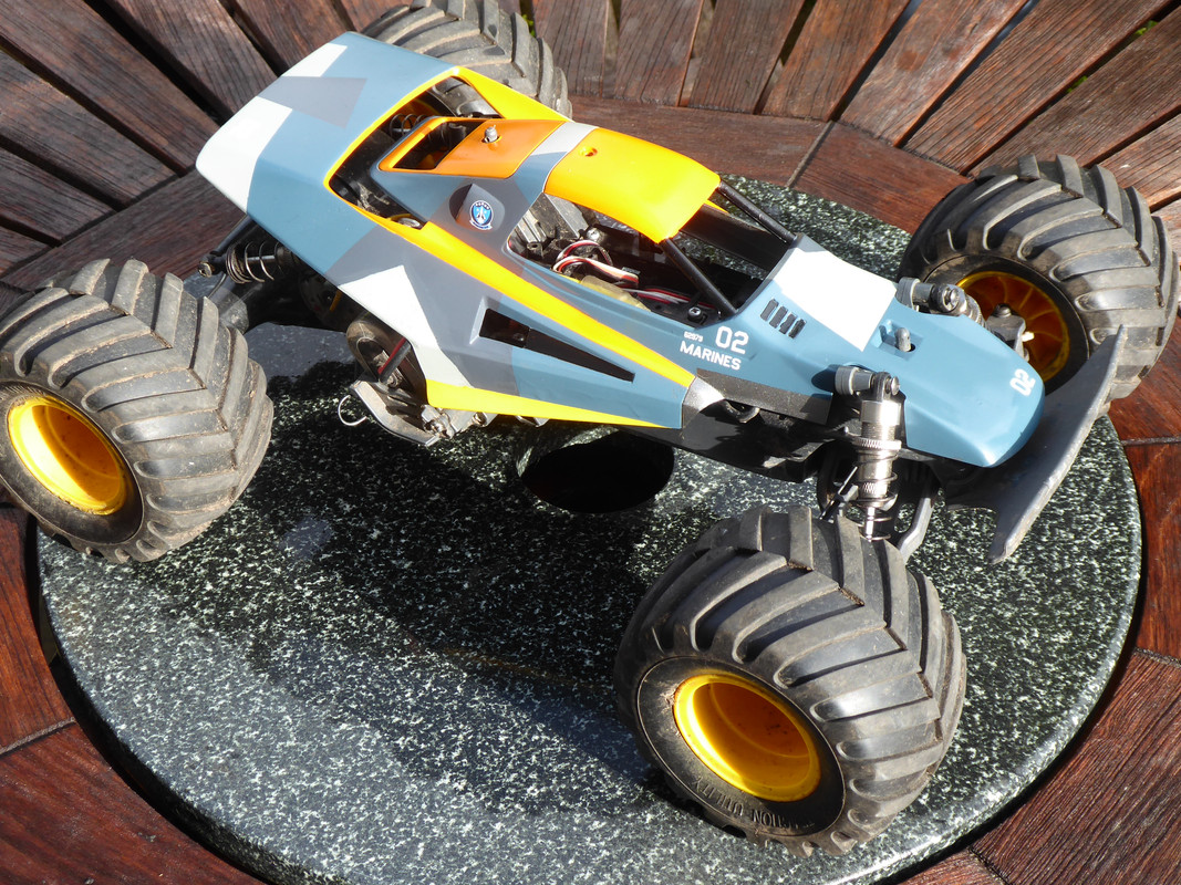

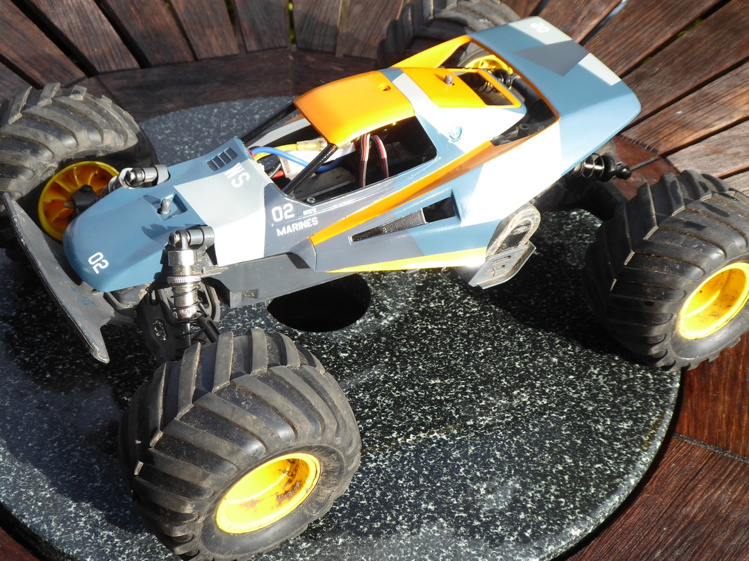

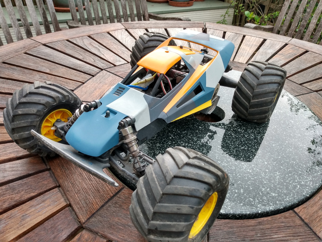

Posts: 1904
We’re going to need a bigger boat!
https://flic.kr/p/2jaSdKL
https://flic.kr/p/2jaWbK4
I knew truck tyres were going to be bigger but I never expected that big.
Anyway, brushless motor and ecu are fitted. Holy flaming balls of poop!!!
Trial run in the garden resulted in uncontrollable back flips and hair trigger. Quickly turned down the initial punch setting to its softest and it’s now much better. Definitely have to drive the car rather than just punching the throttle all the time, but good fun. Still very easy to donut and power slide if you want to. Increase in speed is mad. One thing I hadn’t expected is that it’s so easy to jump using the throttle rather than just pure speed, makes landings more controllable. Unfortunately, the dirt jump yoofs were using the bmx track, so I couldn’t see if I can now clear the doubles. Tomorrow maybe. Only issue is the tendency to grip roll, if I come off the throttle too hard. Needs some more suspension fettling to help with this.
Have also added some motorbike wheels weights (40g so far) to the front of the car to help with balance.
Final tweak was to add some heavy diff oil. Did a bit of reading and went for 500000 cst, which is like clear treacle. If you remember soft eject cassette players, it’s very like the stuff they used on the eject mechanism. Has really stiffened up the diff and helped me get out the car out of soft stuff that would have had one wheel spinning away on its own before.
Next plan is bigger front tyres. Have wider mad bull axles and have hex adaptors coming. Not sure whether to use wider buggy wheels or go bonkers and get a set of mad bull wheels to use truck tyres.

Got my lunchbox up and running 😎
Had a bit of a play with the suspension on it as stock just means it pushes under power and understeers off the power until it gets to a certain speed then grips and tries to turn over. The issue is the front suspension puts loads of positive camber on at the standard ride height so that only the outer half of the tyres is in contact with the ground. As I've got the standard shocks on it it's easy to add some spacers to the top of the rods to lower the ride height using some cut rubber tube left over from the bump stops. 10mm on the front and 6mm on the rear sorted it and gave it a bit of a rake too (channeling my inner Newey...). Behaves much better now with predictable front turn-in and it can now be made to have some lift-off oversteer!
Have decided to paint the shell the dark blue I got too, leaving the wheels the standard yellow for now but think I may go chrome. Did have a bit of an issue painting the shell though, was being a bit too cautious with the fine coats so it was not getting particularly glossy. Sanded back the paint and went for a slightly heavier coat and it worked! Trouble is I only got one side done as the tin ran out. Another one ordered but means I have to run it sans shell for a while longer. Was hoping to get the paint done today so it could dry and have the decals put in tomorrow before putting a clear coat on over the weekend.
Think I've got the bug again. Next payday may involve ordering a 4wd buggy of some description if there's any stock available 😁

Thought I'd do a little update on the Lunchbox progress as I've been busy doing a mod or two!
Did the ride height mod as detailed above, greatly improves the handling and stops the front suspension generating loads of positive camber.
Before:
[url= https://i.postimg.cc/4nCN0SGJ/20200610-183250.jp g" target="_blank">https://i.postimg.cc/4nCN0SGJ/20200610-183250.jp g"/> [/img][/url]
After:
[url= https://i.postimg.cc/c4Mrjdv2/20200614-132845.jp g" target="_blank">https://i.postimg.cc/c4Mrjdv2/20200614-132845.jp g"/> [/img][/url]
Much better and has added a bit of rake to the chassis too.
Next thing to look at was addressing the slap of the rear suspension as you put the power on, a known issue. Looked at the 3rd shock method and at a brace for the pivot arm. It was this that got me thinking. It's £20 or so for the pivot brace online but I'm sure I could make one from the spares in the kit. Found a black part 9 that was roughly the right shape and a spare shock mount. Cut the plastic part to form a mounting platform for the shock mount. The shock mount then got tweaked to fit around the gearbox pivot housing like so:
[url= https://i.postimg.cc/jS43LnLc/20200614-131013.jp g" target="_blank">https://i.postimg.cc/jS43LnLc/20200614-131013.jp g"/> [/img][/url]
Drilled a hole so I could mount it to the battery tray and a corresponding hole in the tray and used a spare small but and bolt to securely attach it:
[url= https://i.postimg.cc/K88BD10J/20200614-131258.jp g" target="_blank">https://i.postimg.cc/K88BD10J/20200614-131258.jp g"/> [/img][/url][url= https://ralphrobertspersonaltrainer.com/dont-drink-calories-5-low-cal-alcoholic-drinks-for-your-tropical-vacation ]best low cal alcoholic drinks[/url]
Bolt it all back together and the result looks like this:
[url= https://i.postimg.cc/bNNsKK1v/20200614-132134.jp g" target="_blank">https://i.postimg.cc/bNNsKK1v/20200614-132134.jp g"/> [/img][/url]
[url= https://i.postimg.cc/9MdDh2xD/20200614-132113.jp g" target="_blank">https://i.postimg.cc/9MdDh2xD/20200614-132113.jp g"/> [/img][/url]
No more slap when putting the power on and the suspension still articulates fully as it should!
All for the total cost of £0. Very pleased with the result.
Posted : 14/06/2020 2:41 pm
