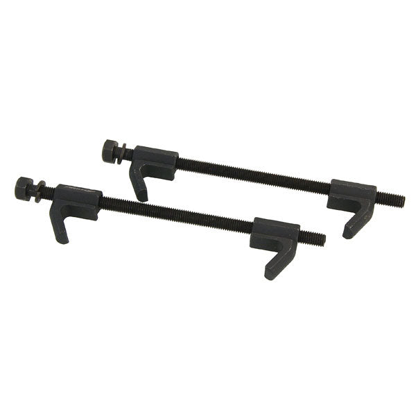

Looking to replace the springs on my Polestar, and though the rear will be straightforward enough, it seems to remove the spring/damper unit from the front (mcPhearson strut) you are advised to use a special Volvo tool that appears to be a HUGE G-clamp, which compresses the shock unit enought to be able to remove the lower ball joint.
It seems others without this tool has had to either remove the lower sub frame, or have used a linear jack (the type you hold a gearbox with) with the car on a ramp-lift, in order to compress the shock enough to remove the lower ball joint.
See here:
Is there anything stopping me using a spring compressor (AKA Widowmaker) with the shock still on the car, in order to comress the spring i.e mimiking the function of the giant G-clamp?
I'm thinking if I were to compress the whole shock unit, then the ball joint can be lowered off the hub assembly, the hub removed from the shock...and the shock lowered out (still compressed).. and then reversed to reinstall...

having watched that video - that's the correct and only way to do it.
It's the same configuration as my older Volvos except the bottom ball joint attachment is slightly different. The complete strut has to be removed because the spring is retained by the top strut bearing/spring retainer.
The spring needs to be compressed enough to undo the top strut bearing retaining nut without it firing into orbit. You need to figure a way of stopping the chromed shock absorber shaft from turning when undoing the nut - on mine is a torx on the end of the shock shaft. There are a few steps missed in that video.
Be careful - I use two different sets of spring compressors in conjunction with a ratchet strap. Stored potential energy can be deadly.

I have used a spring compressor before, albeit back in 1987 trying to replace the lower part of the suspension strut on my old Opel Manta A-series.
It was a nightmare, really really difficult crap job to do and it ended up breaking my mates finger that got trapped. He was lucky it remained on the end of his hand.
We did have this really crap tool, which was something like this in the link (can't post pics sorry)
Whilst winding them down both the clamps slipped round to the same side of the spring but my mates hand was in the way 😲
https://www.eurocarparts.com/p/sealey-ak3841-coil-spring-compressor-2pc-seaak3841?gad_source=1&gclid=Cj0KCQjw_qexBhCoARIsAFgBletuyz12sz31AbY3C4maN9E_2_k5Tymsu0Nb8pFK1z9ESeYyuYBZ4PAaAjcEEALw_wcB
Highly recommended not to go with this approach.

You can now buy affordable hydraulic spring compressors much like a garage will use  there is. Vevor brand one with two sets of spring holders for about £120 .
The old threaded rod things work but it’s hard work and risky , even with a hydraulic stand up one you really need to pay attention- an impact driver is very useful for loosening top nut you can free it off with the spring under tension usually- saves wrestling with it with the spring compressed and the risk of dislodging it.
Take care it’s one of the most dangerous jobs on a car.

Many many moons ago I did a complete strut change on my XR2. I had to drop the lower arm to get the strut in and out. I didn't like the threaded compressors. They just seemed a sketchy way to do it. It was not a fun job. The cheap compressors are hateful things. I didn't need to compress the springs a huge amount for that job and it still felt really sketchy.
Those large stand up units look ok. They seem to avoid the possibility of the compressor slipping on the spring. You can always flog it on after you've done the job.
This one, I'd flat out pay to have someone else do it with proper tools.

I've swopped while units for coil overs before, and if course that's ok cuz you don't need to compress any springs!
However, on the P2 it appears you need to compress the spring UN SITU in order to even get the shock unit out...
I'll have to check if there is enough space to actually get the clamps in there with the shock in place...
If I can't then it's a non starter anyway!

The main issue is, that I probably didn't make obvious in the OP, is that in order to even remove the shock assembly, the unit needs to be compressed. This is because it seems that unless the shock is compressed, you can't remove the lower ball joint and slide the hub assembly off the shock...
So I need a way of compressing the shock whilst it's in the car...
Heck, I guess once I've done that and got the shock out completely, I could even take the whole assembly to a local garage to do the dangerous bit (i.e take the top cap off and actually swop the springs)..
I guess, until the top cap is off and the spring is au-naturel, there's probably not much that could kill me whilst the spring is contained on the shock...
Probably...

I had to replace the top mount on a strut recently. Didn't do it in situ but did use these compressors. They have a safety pin that would stop them sliding off catastrophically. I reckon you'd be able to use them with the shock on the car.
https://www.amazon.co.uk/gp/aw/d/B0836F8LCF?psc=1&ref=ppx_pop_mob_b_asin_title

Posts: 15555
The trick is to use 3 (or ideally 4) at a time equally spaced around the spring, and wind them up alternately a tiny bit at a time to keep the pressure even.
And only compress the spring just enough to do what you need.
Decompress it the same way when off the vehicle... As in keep the compressor clamps on but take 95% of the tension out. Recompress to refit.
Also be very careful and gentle where you point it when off the car.. Treat it like a loaded (and faulty) gun.
If you are very methodical about it, it's not a problem.

The ones I use are simmilar to this.. but I don't use them in pairs, I use 3 or 4 at a time so theres less chance of the spring bowing or flexing to one side if you tighten up one a bit more than the other, which you shouldn't ever do, but just in case..
https://www.neilsentools.com/products/ct0917-2pc-coil-spring-compressor?pr_prod_strat=e5_desc&pr_rec_id=35822a3e6&pr_rec_pid=8223741870389&pr_ref_pid=8221916627253&pr_seq=uniform

Compressing the springs (and technically the whole damper unit) whilst still on the car is completely normal, and exactly how you remove the front suspension on most macpherson strut style cars. Not sure what all the fuss is about. Yes, Spring compressors can be dangerous but so is jacking your car up.
Use the right precautions, be methodical and safe... Its fine.
What exactly do you drive with wheel wells that can fit 4 spring compressors ?  Bob Chandler's big foot?
Toyota land cruiser... heheh, nah just kidding, I already own a dog.
The ones I linked too are only small, once you've put two on just tight enough to be able to rotate the spring, you can rotate the spring and fit the other 2.
Or if not enough clearence, just use 3...spaced appropriatley of course.
Or if there's really no clearence, just fit 2 (opposite each other) until you can remove the whole shock assembly off the car, and then quickly put another two on for extra safety. Dont be dropping it or chucking it around, obviously!

"Take care it’s one of the most dangerous jobs on a car."
It's the only job I won't even consider tackling on my car after having a very near miss back in 2011.
Was changing the cracked front springs on my Fiesta (they'd last 2-3 years at most) and was using a brand new set of 'Widowmakers' that I'd bought from the local Motor Factors, Sealey branded. As I was doing the final compression on one it snapped at the top jaw, causing the spring to twist and snap sending a bit of it flying down the full length of my 2 car long garage. On it's way it snagged the top of my hand and knocked my glasses clean off. While snagging my hand it managed to rip out a big vein, tear a flap of skin off and put a small nick in the tendon of my index finger. Took me a few seconds to find my glasses and then as I was putting them on I noticed the blood oozing from my hand! Cue a quick drive to the local A&E 6 miles away and straight in to get the blood flow stopped. I'd had my hand in a cloth and a small jug, it measured nearly half a pint in the jug plus whatever the cloth absorbed by the time they stopped the flow. Apparently I was incredibly lucky the tendon survived and that the vein tore rather than ripped out a length of it as that's harder to fix quickly. While the nurse was getting ready to stitch the wound up I told him what exactly had happened, fleshing out the basic 'working on my car' info I'd given while they were stopping me bleeding. He stopped his needlework, stared at me for a second then said 'Buy a lottery ticket, you've got luck on your side right now." He'd been a nurse for over decade and in that time he'd seen a few terrible injuries from doing the same job on cars, professionals and amateurs like me, including one death from bleeding out when the artery had been punctured.
I've never touched a spring on a coilover since. In fact my current car is having new shocks and top mounts tomorrow and I'm more than happy to pay the £400 to the garage than risk another accident.

You need to figure a way of stopping the chromed shock absorber shaft from turning when undoing the nut – on mine is a torx on the end of the shock shaft. There are a few steps missed in that video.
I used to have a special smart car tool for this, it was 2 pieces of aluminium that you bolted togeather on the shaft which had a shape that you could put a silly large spanner on which then allowed you to undo the nut.

I own a pair of spring compressors . It's one job I probably wouldn't do again, it was absolutely terrifying. Torquing down a big spring to roughly half of it's uncompressed length using a half drive socket set and lots of chainsaw oil was bonkers.
Problem is without a massive bench vice you have to hold the spring to counter the rotation forces and that means putting yourself in harms way.
Ok , so the Merc is a huge , heavy car and probably has a heavy duty spring but you could see the wear on the threads of the compressors as it tightened up even with a heavy oil .
Posted : 26/04/2024 12:19 pm
Posts: 39914
This is why compressing them on the car works well.
Your starting from a pre compressed state with the weight of the car on. As well as them being restrained to counter the force of you compressing them
Posted : 26/04/2024 12:32 pm
Daffy and Daffy reacted
Posts: 661
Similar story to others from me. I own a pair of the threaded spring compressors, aka suicide sticks. I've successfully used them to replace all 4 springs on my old 2.0 petrol B3 Passat in the past, however, modern cars are heavier and the springs are more substantial to cope with the extra mass.
3 or 4 years ago my Peugeot 307 1.6 HDi snapped a spring. I ordered a pair off Ebay with the intention of DIY replacing them, but when they were delivered they were huge! I double checked they were the right part for the car and promptly booked it in to my local garage for them to replace. The thought of compressing these springs was not something I wanted to entertain. Paying a garage £120 to do it for me was money well spent.
There are better types of spring compressors on the market now that clamp more of the spring, but I'm not sure you'd be able to fit them with the strut assembly in situ.
Posted : 26/04/2024 12:33 pm
