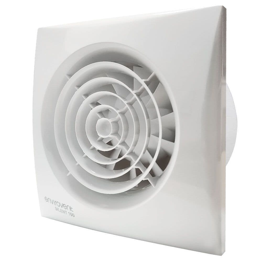

Going to put an Extractor fan in the bathroom. Does anyone know if the ones with Humidstats are worth the extra cash? Do they also come with timers? Or shall I just save some cash and buy the timer only option?
The 2 I am looking at are
http://www.extractorfanworld.co.uk/soler-palau-hi-power-silent-bathroom-fan-with-timer-sil100t-3191-p.asp
http://www.extractorfanworld.co.uk/soler-palau-hi-power-silent-bathroom-fan-with-humidistat-sil100ht-3193-p.asp
It will be running from the bathroom straight through the gable end of the house to outside.

Humidistat fans are a pain they go off all the bloody time and rattle away during the night for no reason. Just get a timer one.

I bought an expelair humidistat centrifugal one for about 100 pounds for a the bathroom. I wouldn't pay extra for the humidistat. Just get one with a pull cord operation

Pullcord - guaranteeing it never gets used
I wired mine to come on with the light and go off 10 minutes later. Comes on when you go for a whiz but so what

I got a humidistat one so that it would stay on while the bathroom cleared. It also had a timer so it would stay on for 10 mins after the lights.
It worked ok but the humidistat took a lot of fiddling.
