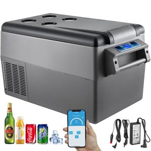

I have been looking at the 12v compressor fridge from vevor that seem to get ok reviews and cheap. Can't quite justify ATM as we are only camping / holidaying in the UK so living with no / passive coolbox is not really difficult.
https://uk.vevor.com/car-refrigerator-c_10723/35l-portable-car-refrigerator-fridge-electric-cooler-freezer-for-picnic-travel-p_010479754921
