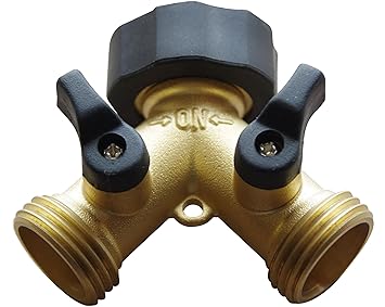

Just get one of these and use a 2nd short hosepipe.
Posted : 09/03/2017 10:56 am

then just get a second hose to run round from your current tap....
I've already suggested that but using a y splitter at the original tap so the issues below don't happen.

stumpy01 - Member
Not that this is being over-thought or anything........but if it's gonna be that much hassle to turn off/on an isolator every now & again, then just get a second hose to run round from your current tap....
I do exactly that with a splitter like Gary M suggested. Never had an issue with Hoselock fittings. Just turn the tap off when you finished with it rather than let the pressure build up against the Hoselock fittings?
