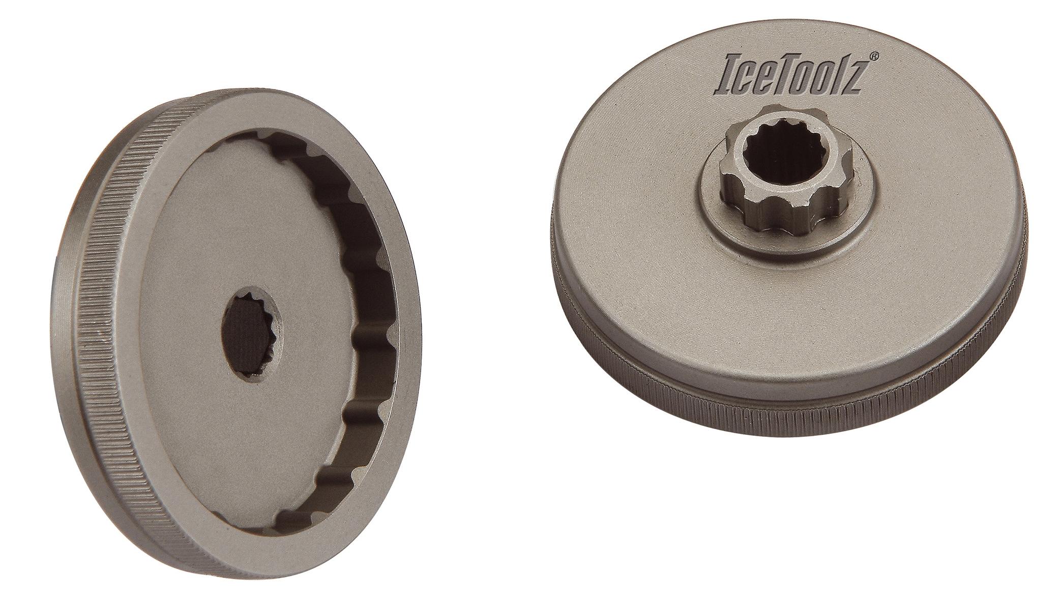

the axle pre-load cap is only tightened 1-2nm
very easy to overload, and often overloaded by mechanics both at home and in bike workshop
[img] http://i1.adis.ws/i/washford/544835?$pd_main_v2$ [/img]
especially with companies making metal tools to tighten this cap
this drastically shortens bearing life
Posted : 15/12/2015 5:09 pm
Yeah that's pretty stupid.
