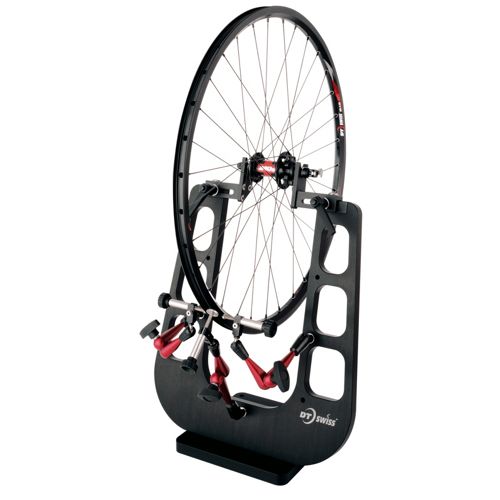

truing jig here, I machine these out of 25mm plate,
https://www.flickr.com/photos/compositepro/14971701499/in/photostream/
Posted : 27/09/2014 7:53 pm
 JoeG
That DT is a beaut! You just cant beat the Park though... Will last the rest of your life, and though is over your budget, will hold it's value really well if you should ever change your mind 🙂
[url= http://www.chainreactioncycles.com/s?q=park+tool+professional+wheel+truing+stand+ts2.2 ]linky[/url]
Posted : 28/09/2014 3:30 am
Mike, that one is lovely - do you have axle clamps or use the quick release?
I use a Park TS-3 - not many of them about 😉
Posted : 28/09/2014 8:42 am

You guys are just messing about with your DT and Park stuff. This is what you want: I guve you a PK & Lie truing stand.
Posted : 28/09/2014 9:14 am
Ben the end does both types and it has a disc dtraighttness widget
I like the disk straightness widget
When I looked at the pk one the weak part of it was the axle holding ,it can be bent, this plate thing came about for doing super stiff carbon rims,it don't bend anywhere
A couple of builders who tried the prototype were trying to adjust to it ,its kind of one of those you don't need to worry about things with this
Posted : 28/09/2014 9:30 am
The P&K things are gorgeous, but the ones ive tried aren't as rigid as they look - not any more rigid than my Park. Their spoke keys are excellent though. Only beaten by old Sturmey Archer.
Posted : 28/09/2014 12:26 pm
Ben I got hold of one, I really thought they were the dogs until like you say you start handling it then you think can I mod this that and tother,
That park, i actually thought that was the standard by which all tothers were judged
Posted : 28/09/2014 1:01 pm
The great thing about the Park is the lever action automatic centering - very quick and accurate. But there is some flex so you have to do the QR up to make it rigid and accurate.
Not a massive deal. A bit of a pain with nutted hubs which can move when you tighten the nuts, I've been thinking of a fix for that using toggle clamps.
