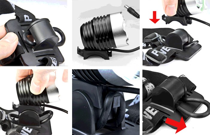

Posts: 1055
Does anyone know where to get a helmet mount like this from ?
Its the Magicshine / generic Chinese lamp headband mount
But I cant seem to find it listed separately

Posts: 14720
[url= http://www.bikelightsuk.com/accessories/magicshine_helmet_mount_for_all_magicshine_lights_mj872_mj816_mj808e_P577.html ]somewhere to start[/url] can't say it the cheapest you'll find it or if the supplier any good, as I found that one while just looking for one to use as an example.
Posted : 17/09/2013 1:26 pm
Posts: 1055
Cheers Zippy 8)
Posted : 17/09/2013 2:13 pm
Posts: 818
cr500dom - I've probably got one you can have for the price of a stamp (or however much it costs to post).
