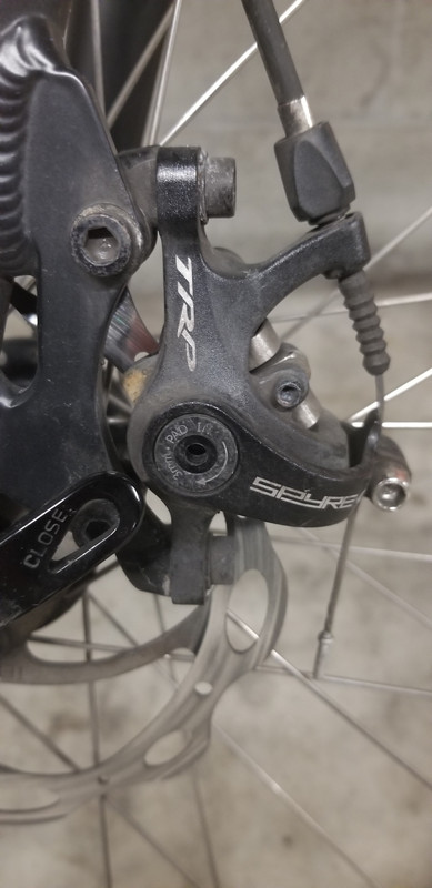

Bear with me...
Posted : 28/09/2021 10:55 pm
Rear
Posted : 28/09/2021 10:56 pm
Apologies for multiple posts but it seems that I'm too incompetent to be able to add text plus two images in one forum post using my phone!
Anyway, it seems like the TRPs are out of stock until at least May '22 but they cost $175+tax (CDN) per end, whereas Juin Tech R1s cost $209 + tax for front and rear inc hardware and rotors, and I can have them tomorrow via Amazon...
R1s are sold in post mount and flat mount versions but mine use the very old IS standard but are currently using flat mount Spyres.
Can I safely assume to order the flat mount Juin Techs?
Note: rear rotor is currently 140mm but a 160mm rotor is supplied so I guess I need a different type of adaptor.
(And I probably want new compression-less cables as well?)
Posted : 28/09/2021 11:03 pm
 Aidy
Posts: 2990
Those pictures are of post mount Spyres. Post mount R1s should be a straight swap.
Posted : 28/09/2021 11:06 pm
@Aidy
Good point, I wasn't sure what the difference was between post mount and flat mount until I looked more closely.
Anyway, I've ordered some post mount Juin Tech from Amazon and should have them tomorrow...
Cheer guys!
