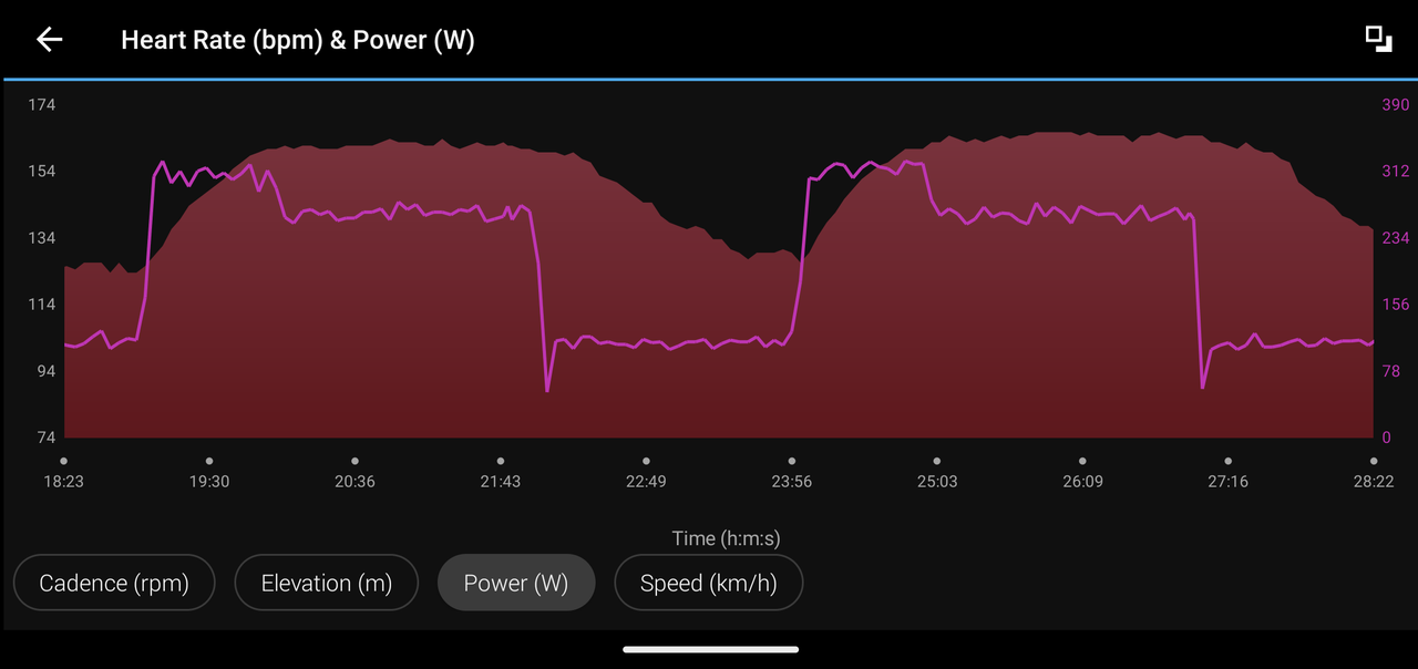

Completely normal, it's why power is a much better way to measure performance - heart rate is always a little delayed, and can be affected by caffeine, stress, lack of sleep etc.
Your recovery rate after an interval will improve as you train, so it'll start to come down sooner after the interval, and faster once it start to come down.
Here's one of my graphs from Saturdays 1.5hr threshold workout, the 1 min high bits are at 307w and 321w and the low 2 mins just under FTP at 265w (my FTP is 279w).
