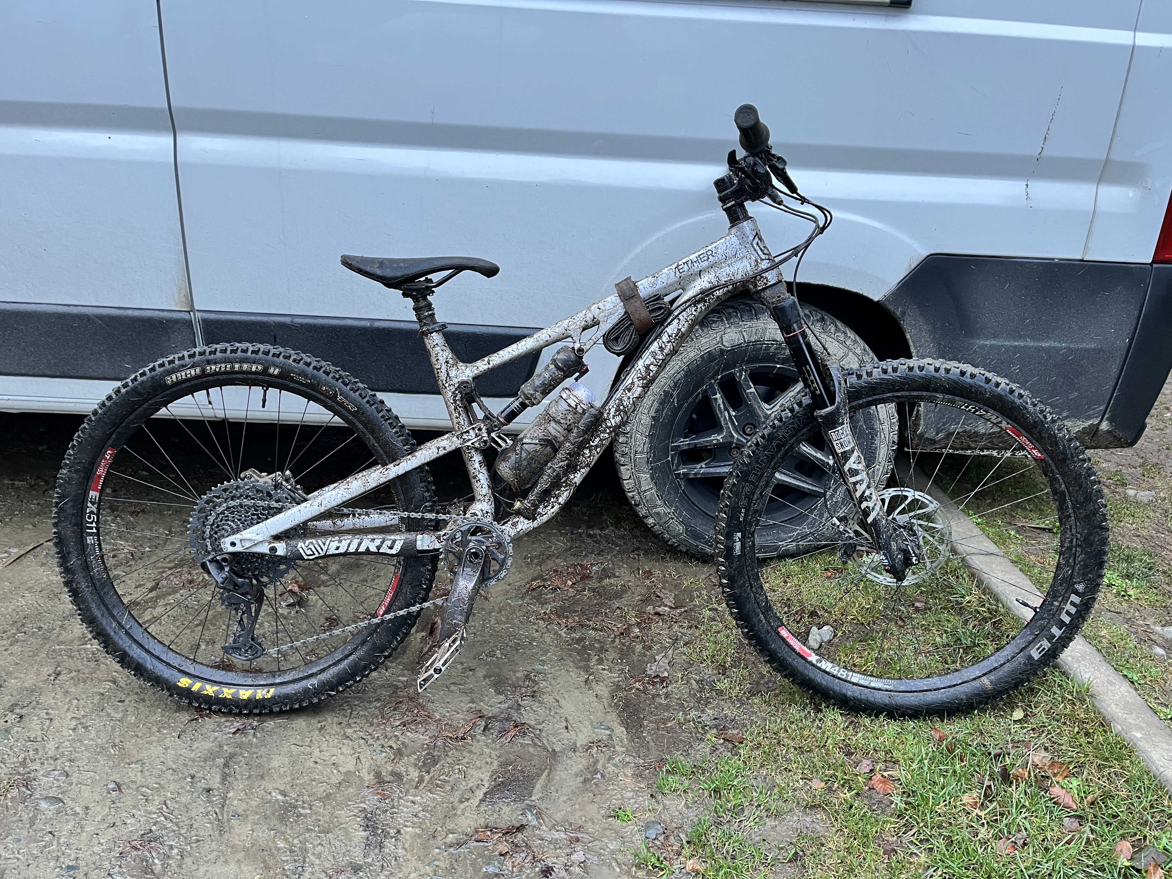

Posts: 10361
Transition with the saddle slammed (210mm drop)
[url= https://i.postimg.cc/VvvQ9FX3/223C2A38-3CD1-4A99-8924-714E28C44BD0.jp g" target="_blank">https://i.postimg.cc/VvvQ9FX3/223C2A38-3CD1-4A99-8924-714E28C44BD0.jp g"/> [/img][/url]
I can’t find one with the Aether slammed but it did get pretty low.
Posted : 12/06/2023 2:13 pm
Posts: 863
That's more like it - looks almost slope style!
Posted : 12/06/2023 2:17 pm
