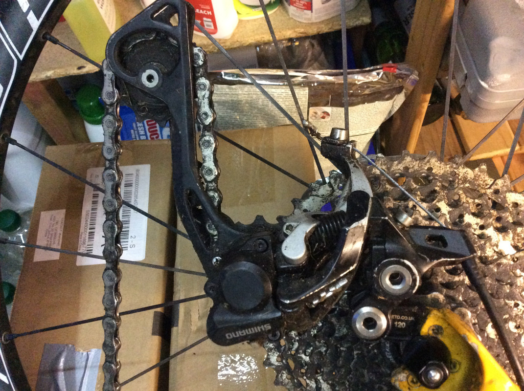

New cassette time and have seen the 11 46 sunrace 10 speed.
Is my mech ok to run it?

Looks like it. Can't quite make out what it is.
Medium or long cage you should be sweet.

I got a sunrace 46t cassette recently, running it with an xtr 10 speed mech.
The b screw wasn't quite long enough to clear the big ring on the cassette so got a wolftooth goatlink and that sorted it.
