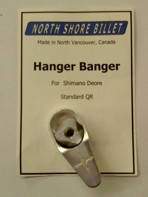

I remembered a bit of kit that was held in place by the QR and plugged in to the derailleur allen key hole, do these still exist?

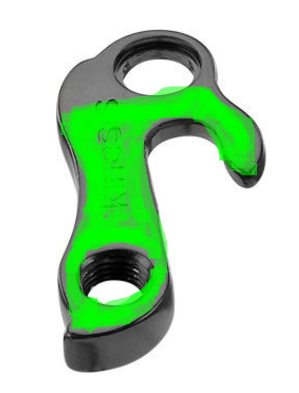

Maybe make a reinforcing plate out of 1.5-2mm steel or stainless steel (drill, hacksaw, file). Covering the green scribbled bit below.
Clamp it on using the mech and qr.
It still leaves a weak bit to bend in a big crash.
The GRX mech has a fairly weak aluminium attachment plate anyway (my lad has bent an xt one rather than the breakaway aluminium bolt on his mtb).

It sounds like you want a North Shore Billet Hanger Banger. Amazingly some places are still selling them-
https://bicyclechain.co.uk/product/11320/hanger-banger-for-shimano/

The Hanger Banger was what I was looking for! I don't believe I'm hitting stuff hard enough (or at all...) to somehow break the frame as well so I could be tempted. Or I just buy yet another hanger and try extra hard not to drop bike on its side posing it for photos...
