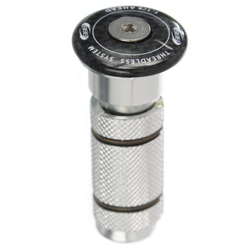

Lifeline:
[IMG] ?w=430&h=430&a=7[/IMG]
BBB:
[IMG] http://media.chainreactioncycles.com/is/image/ChainReactionCycles/prod29884_Black_NE_01?wid=500&hei=505 [/IMG]
Knurls looks more substantial and goes down further so will provide more support when I place a spacer above the stem?

User error it is!
Normally I undo the cap, then stem and finally the bunger. This evening I undid the cap followed by the bunger - low and behold it was stuck. Meaning that the steerer was clamping on to it! 😳
Anyway the new bunger is in and is much longer than it's predecessor:
I also added a dab of carbon paste on the bunger too.
Looks a little strange with a spacer above ❓
