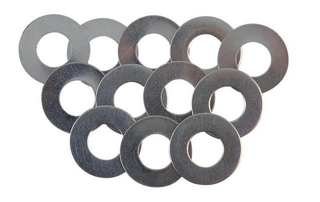

I had the same problem. I got some of these and now I don't.
[img] http://i1.adis.ws/i/washford/543431?w=637&h=403 [/img]
http://www.halfords.com/cycling/bike-parts/bike-brakes/a2z-disc-brake-caliper-spacers
You have to fit them, obviously. And figure out which wheel to space. Just buying them won't work on it's own.

Yep spacers were the answer! Application of two thinnish washers between mount and caliper were enough to improve the rear markedly. The front which was never as bad as the back sorted itself after a short ride.
Thanks for all the suggestions
Posted : 17/01/2017 12:56 pm
Posts: 12553
Good work.
But you'll have to reverse that when you swap back to your other wheels.
If you going to be swapping back and forth more than a couple of times a year (or even more than once!) space whichever rotors that are furthest inboard. The wheels will then be near enough identical and you can swap back and forth without messing with your calipers.
