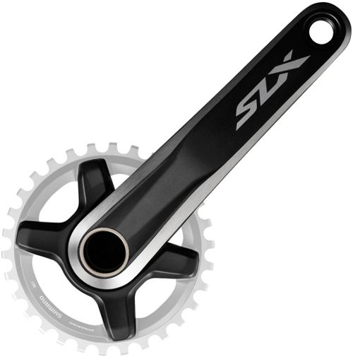

The new SLX chainsets look quite s****y IMO, happily put one on my new build.
[img] http://chainreactioncycles.scene7.com/is/image/ChainReactionCycles/prod148289_IMGSET?wid=500&hei=505 [/img]
