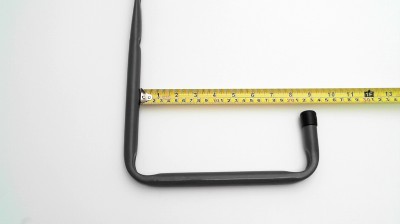

Posts: 9984
Only used it to blow the dust and grime out of the brake callipers. It came with a long nozzle to do that and it works fine.
It was only bought for the blowing up of tubeless tyres though. If I needed anything else my dad has full workshop facilities as he restores old cars.
[img] ?oh=11f86025675ffb31b92340069917dc7c&oe=58369748[/img]
[img] ?oh=153f4f07f6811926b485b73c1c2c3a78&oe=5834823A[/img]
