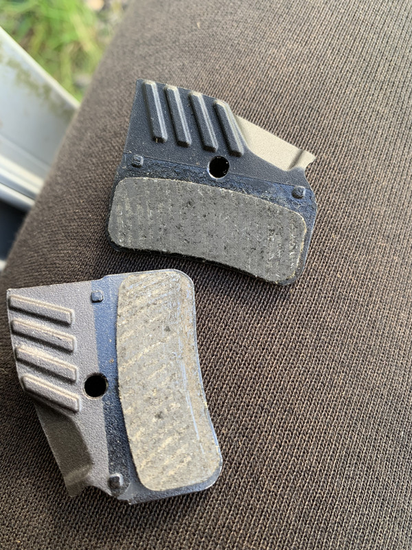

Noise is only coming when coming to a full hard stop. Under light braking no noise. Took them off too see how they look (pic attached). Both front and rear making some noise.
The rattling is terrible. Front the worse. Maybe I should just try a set of non finned resin ones and clean up the discs and go again.

Those pads aren't fully bedded in, you can still see the machining marks on the braking surface.
For the rattling, try bending the spring clip out a bit more, if you haven’t already.
I've almost always had to do this with Shimano pads. Makes a huge difference to noise and really helps with clearance too.
