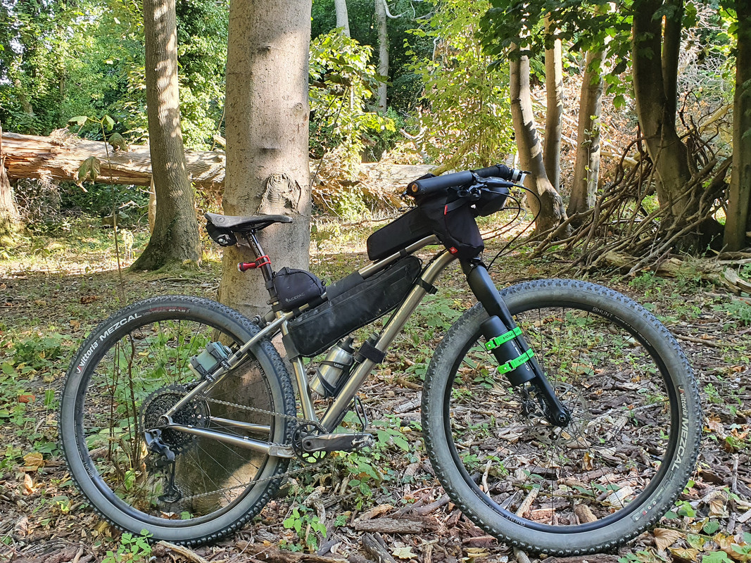

Posts: 522
@damascus i went for the "small" ones with 3 eyelets rather than 4 (think they also now a "mini" version with two bolt holes?). Use with voile straps, pass the strap though the the slots, behind the fork leg and back out the slot on the other side (then cinch up round the bag or item to be carried). Seems to hold things more tightly than my previous PX set up.
