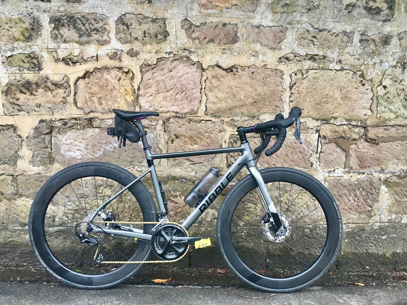

mine are 23 internal 30 external Prime

I’m talking internal rim width here. The stock wheels supplied with the bike are 21mm internal,  my mtb wheels are 25mm and 30mm and both  of those sets would be way too wide to put on my road bike for road riding.
depends on your tyre size really.  I use Light Bicycle WR50 rims on my Tarmac with 28c tyres, the inner dimension on those rims is just under 25mm and outside of 32.  The tyres measure 32mm on the rim.  Anything narrower tyre wise and you need a narrower rim but 19mm is very narrow these days.

I've also got some WR50's with 28mm tyres, nice and light, stable in the wind and really nicely finished.
