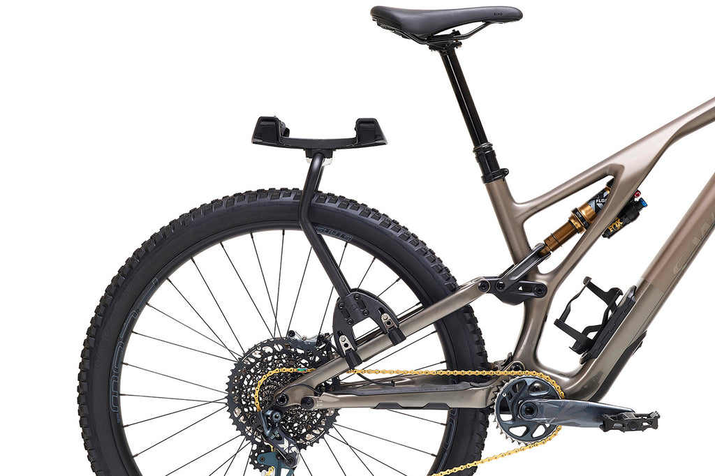

Another option - Aeroe Spider
https://aeroe.com/products/spider-rear-rack
I had the same problem as you, looking at a rack for some adventures on my fatbike. Normally I'd just take the bikepacking kit but I want a bit more space. The fatbike doesn't have rack braze-ons so one option was the OMM rack and an axle from the Roberst Axle Project - that was looking very expensive.
The Thule rack doesn't accomodate fat width tyres. I've seen some clever bodges to modify it though so it remained an option.
Aeroe do a fatbike-specific version of their rack so that became an easy choice. I've only done a couple of short test-rides so far, just to make sure that I'm not getting heel-strike and that everything stays in place. So far, so good.

Thanks @scotroutes I quite like the look of that spider rack.
Looks a bit better mounting system than the Thule and also would come in not too far off the same price (with 3 cradles) if I get some cheaper podsacks dry bags rather than the spendy aeroe ones.
Also look like they have plenty of heel clearance.

How much are you taking? Topeak MTX and Beamrack is a nice option for light touring. Add a bar bag and/or something in the frame. Tubus axle mounting options with one of the seat post clamps above for a proper rack. I've used that clamp for years. That spider rack looks awful for rotational fretting to remove your paintwork but is clearly a solution for a FS rear triangle.
