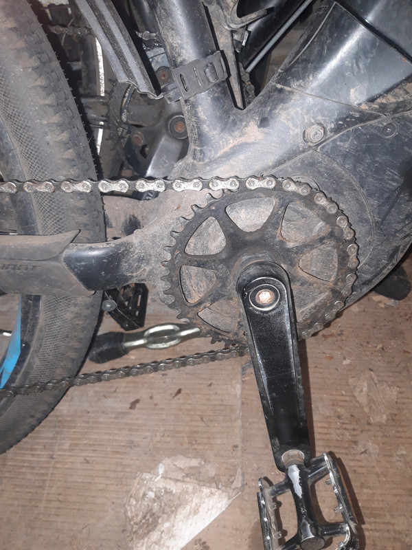

Specifically a 2019 Giant Fathom which was my neighbours mtb until he upgraded and sold it to my my wife for commuting duties. Different tyres, mudguards, a rack and a raised stem and she loves it but wants higher gearing.
According to this the current chainring is a Forged Alloy minimal Q-factor, 36T Steel Direct Mount ring. At a quick glance I'm not sure it's even possible to change it so thought I'd ask on here. Not familiar with direct mount. Thanks.
Edit: bit of reading says of course it's possible. So how big to go? How big will fit?

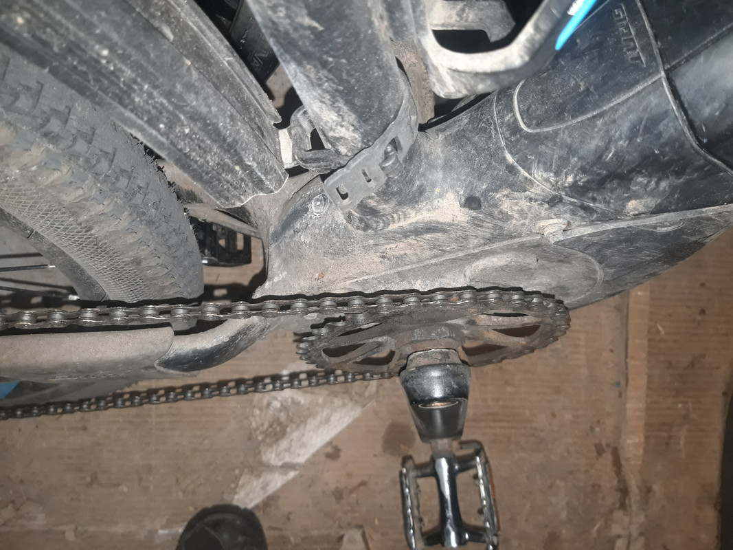

[url= https://i.postimg.cc/vH8bv24R/20230604-125947.jp g" target="_blank">https://i.postimg.cc/vH8bv24R/20230604-125947.jp g"/> [/img][/url]
[url= https://i.postimg.cc/5NtWzHrb/20230604-125935.jp g" target="_blank">https://i.postimg.cc/5NtWzHrb/20230604-125935.jp g"/> [/img][/url]

E-bike chainrings have splined fittings generally unique to the motor - you need to ask a Giant dealer if spares are available. Removal is using a bearing puller. It’s worth mentioning that E-bikes are more efficient when pedalled quickly, rather than grinding out a big gear, plus a bigger chainring won’t make it go faster as you just hit the limiter

Thanks. Managed to get it apart and now searching for a replacement chainring, or a suitable spider (28 splines) and standard ring, taking (3mm?) offset into account.
Not wanting to go any faster but at the moment she's in top gear uphill and down and all that torque on the smallest cog can't be good.
The limiter is set by a sensor on the rear wheel, so shouldn't be affected by the cadence of the cranks, as you say.

Lol. Accomplished, yes. Impatient, yes. Wanting to go faster than the limit, no, but using the full range of the rear cassette will stop her wearing out the smallest cog, hence wanting to put a bigger ring on the front. Have I got that right?
This is the existing ring.

I have a Giant Explore and reduced the front ring - I only ever use it for touring with a tent etc and I have a dodgy knee. I fitted a an Uber bike ring with the correct BCD. Not complicated and I managed to fit it without removing the cranks or the spider. Can't see a problem, going up a ring size?
