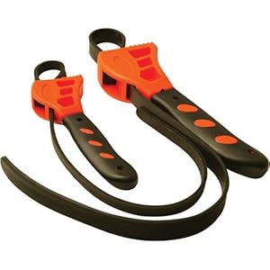

Would a something like an oil filter wrench work? It would hold the one end firm while you adjust the other end?
or
Posted : 10/02/2013 2:38 pm
Oil filter wrench like the one pictured is going to be much to big for the outer diameter of the 15mm axle. Rubber strap wrench: possibly. Worth a try and they are pretty handy and inexpensive tools to have around even if you buy one and it doesn't work. Trouble is you have to stop the axle rotating even the tiniest but whilst exercising some serious rotation on the other end as your tighten the locknut and hold the cone still with the comedy oversize cone spanner. My experience with strap wrinches is that its quite hard to grip a smooth surface well enough. I use a boa constrictor strap to undo air shocks but then its ok if/when the strap slips a bit before it really grips on. To get a good grip with the rubber strap you have to be turning it against something first, which is fine with a shock body held in a vice (or oil filter in car etc etc) but you are trying to immobilise a rotating axle before you start working on the other end of it.
Only other thing would be to see if someone with a lathe will machine you up a copy of the shimano hb15 tool, or just the cups from it: you need to be able to pass an old rear axle or similar through the middle of it so you can do it all really tight and then clamp the disc side cup in a vice or adjustable spanner.
I know his world view a bit unpopular with some on the chat forum (but if you don't know anyone else to ask) Kaseae/katec bearings has made and sold his own bearing presses etc before: it might be an idea to ask him for a quote: I have bought a few bits from him before and he was very quick and helpful.
