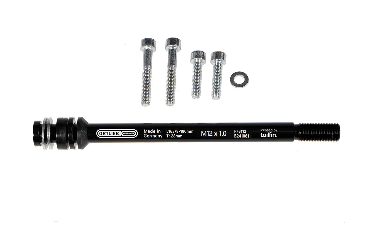

While waiting for the Ortlieb Thru Axle mount for the Quick Rack, I have installed my ~20yr old Blackburn rack on the Camino so I can get some miles in with loaded panniers. Bit of a pull to get the rack stays around the mudguard stays on a bike with discs 😬
Edit:
Have I missed something, are these the new Thru axle stays for the Quick Rack? Can’t see how they would work 🤔
https://www.condorcycles.com/products/ortlieb-thru-axle-m6-connector?variant=55613351592320
Posted : 14/04/2025 11:39 am
Posts: 17398
I imagine the ends of the thru axle are threaded for mounting the stubs. I noted the quick rack has basically the same mounting as the Topeak trailer, and I imagine that their thru-axle would be worth trying too. I don't think I'd go with P clips and heavy loading (I have the light rack version anyway), but I do like the system very much.
Topeak trailer and axles https://www.topeak.com/global/en/products/167-Trailershttps://www.topeak.com/global/en/products/167-Trailers
Axle looks like it would work if the diameters are the same.
Posted : 14/04/2025 1:38 pm
