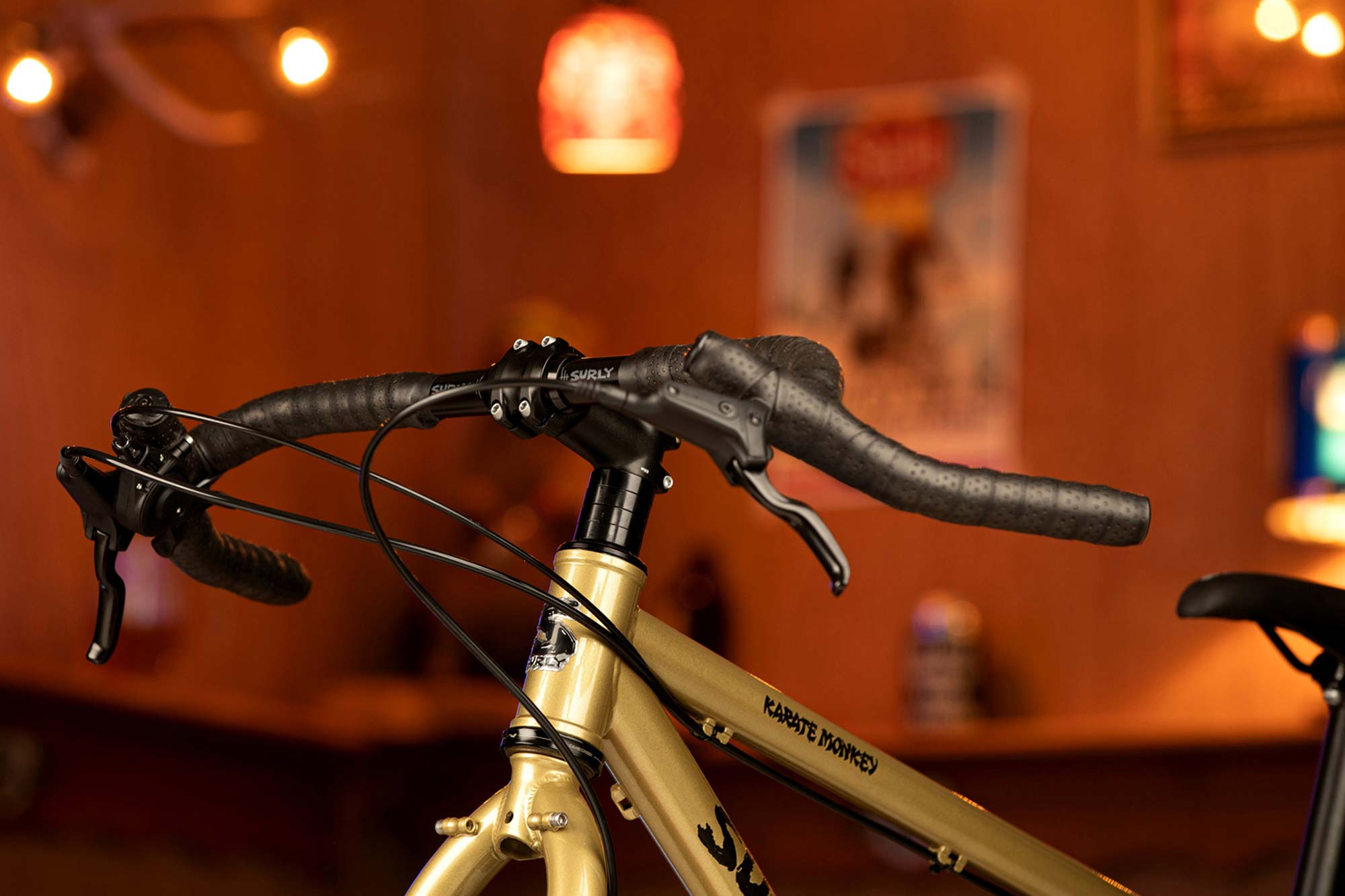

You could try a set of these and then you wouldn’t need to faff around swapping brakes over…
https://surlybikes.com/blog/the_surly_corner_bar_dropbar_mountain_bike_handlebar
https://surlybikes.com/blog/the_surly_corner_bar_dropbar_mountain_bike_handlebar/blockquote >
My god, those bars are ugly (and you'd have to look at them all the time when riding!). Granted, they might be the answer...
