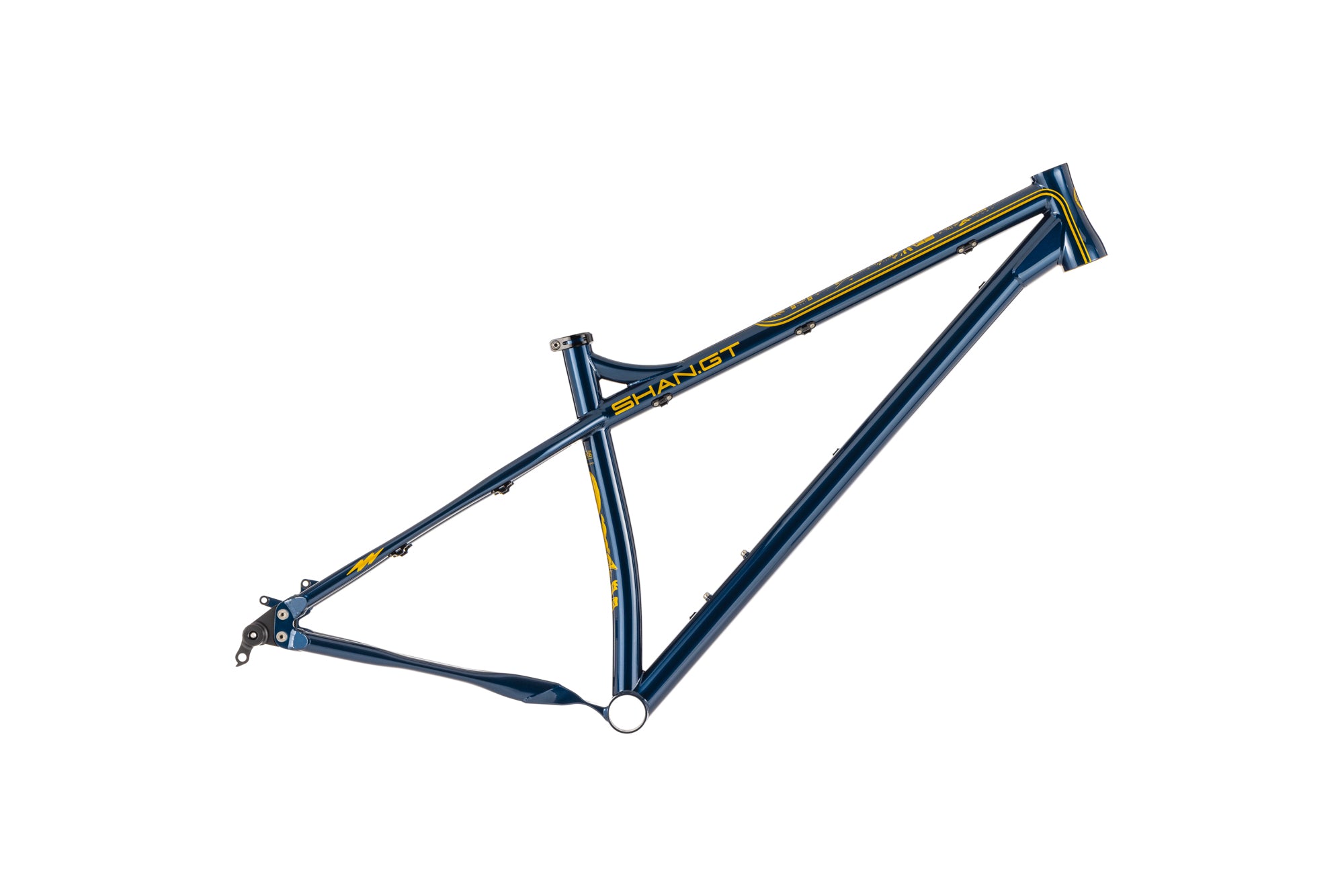

Posts: 2311
Just to throw another option into the mix... not too sure on the geometry but I think they have tweaked it slightly more on the LLS side since I bought mine a few years ago. I've taken it down DH trails and it's way more capable than me 🙂
Production Privée Shan GT
https://production-privee.com/collections/frames/products/new-gt-history
Worth following the link if only to gaze at the gorgeous frames
Posted : 09/09/2024 11:36 am
yorkarl29 and yorkarl29 reacted
