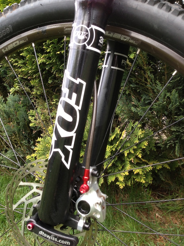

Just bought a [url= ]new bike[/url] with a Hope Tech 2 brakes (160mm front).
I have a Hope rotor (203mm for M4 Mono). Can I just buy an adapter and put it on? I know it's overkill on an XC bike but I've got the rotor already and, has anyone ever said, "oooh, my brakes just work too well!" 🙂
Is [url= http://www.chainreactioncycles.com/Models.aspx?ModelID=13729 ]this[/url] the adapter I need?
Thanks
[url= ]pic of forks[/url] - I think I've got the right model but bought the bike and haven't seen it yet.

http://www.ridefox.com/fox_tech_center/owners_manuals/011/Content/Forks/32MM/32MM_Installation.html
If its 32mm then 203. (If thats the right fork)

Posts: 3226
Seriously consider 180mm max on a 32mm fork.
I'd want to be 36mm before I'd consider touching 203mm discs.
Its a whole lot of unnecessary force to apply to your lowers when grabbing a handful of brake!

Thanks. I will. I only weigh 70kg so it's not like I (or the bike) need the big disks...
Nice bike!
Thanks again. My first after a forced 7 year hiatus. A change from my last bike (a 456 with 150mm Vanillas, Mono M4s etc) but it's time to accept what kind of rider I am 🙂

Im running a 203mm disc on a 2008 Float 32 with no ill effects whatsoever. Mind you, I am 16st ish nekkid and I'd be happier over rather than underbraked every time!

Have 203 hope rotors on my five with 32 forks. Its 3 yrs old and had no issues. As above rather be over-braked than under, and its up to you whether you want the extra weight
