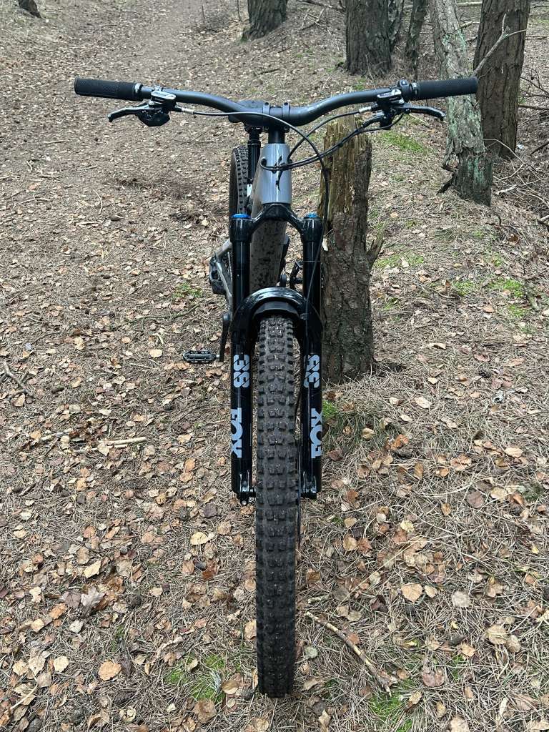

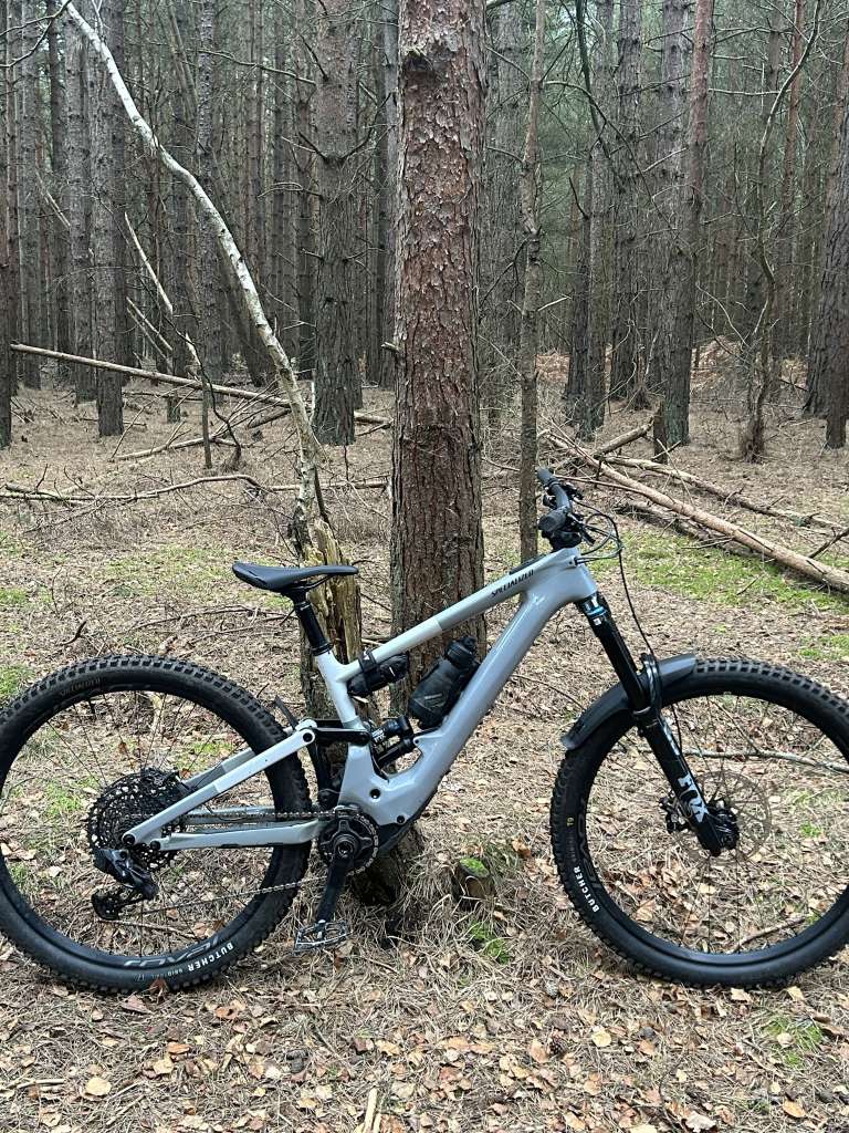

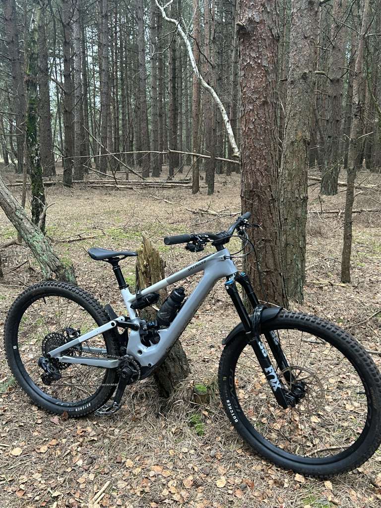

Belated pics of the electric (definitely not a bicycle) bicycle.  Already love the thing!
IMG_0537IMG_0539IMG_0540
