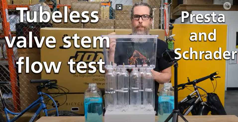

Having bought a Jones bike and also talked to Jeff he is certainly an interesting character.
Here is his simple little flow test on various rims:
videp screen grab
perhaps should normalized the heights of the valve tops, but still for a basic test interesting to watch and also to see how well one brand of presta with the core removed did also.

A win for the Fillmore valves out of that bunch. Nothing comes close without having to remove the core.
