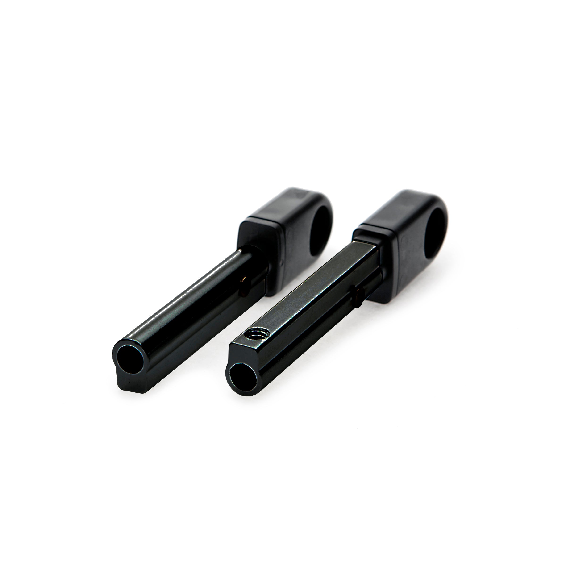

Alternatively, or perhaps as an improvement mod, https://ridepdw.com/collections/fenders/products/full-metal-fenders-safety-tabs
Posted : 27/10/2022 4:26 pm
They test well on bicyclerollingresistance.com and are 400/250g lighter each. Earlier I was looking at gravel tyres and found the Schwalbe G-One Bite/Ultrabite, but according to the tests on that site they somehow roll slower than those Contis despite the version tested being narrower, lighter, and less aggressive tread
Looking at the results it seems there's a good reason for that. The tests are run at set pressures not relative ones. So high pressure for the g1 is the same as high pressure for the race King protection despite it being 75% and 95% of the recommended pressure respectively.
The site looks to be numbers for the sake of numbers and little actual applicable science.

I went for
Just Riding Along Monitor 25mm
Cross King 29" x 2.2 ProTection, Race King 29" x 2.2 ProTection
Velo Orange 700c x 63mm, Problem Solvers Fender Flute, Portland Design Works Safety Tabs
Glanced over quite a few gravel tyre and wheel reviews, and 23mm rim isn't wide even in gravel terms so the Fortus 23 were out. The Pro4 is probably noisier than ideal around town too. Hunt and Silt I wasn't keen on what I read about the Novatec/Chosen hubs, also didn't like the noise of the Silt. Much better experiences on here with the Bitex hubs, and they have bigger bearings too - same size as Hope.

Mudgaurds - I've got VO ones on my gravel bike and they're brilliant. Not too heavy, quiet, superb coverage, nice fitting.
Posted : 01/11/2022 12:58 pm
Posts: 3231
Cheers. It'll be interesting to see if I'm still happy with the rigid fork after swapping the 2.6 for a 2.2.
Mudguards have arrived and the quality is apparent. Didn't get mud flaps, might need the short one for the front though.
