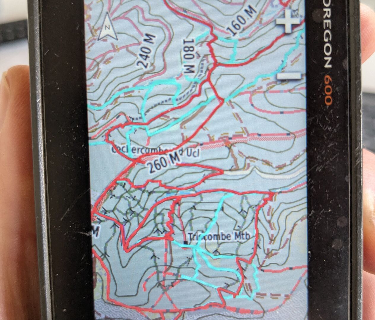

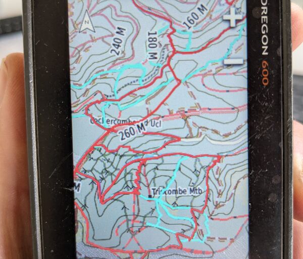

Posts: 12553
9 months later...
No further along! Still going with my Oregon, but it's getting a little slow and hanging up static when I'm moving off from stopped.

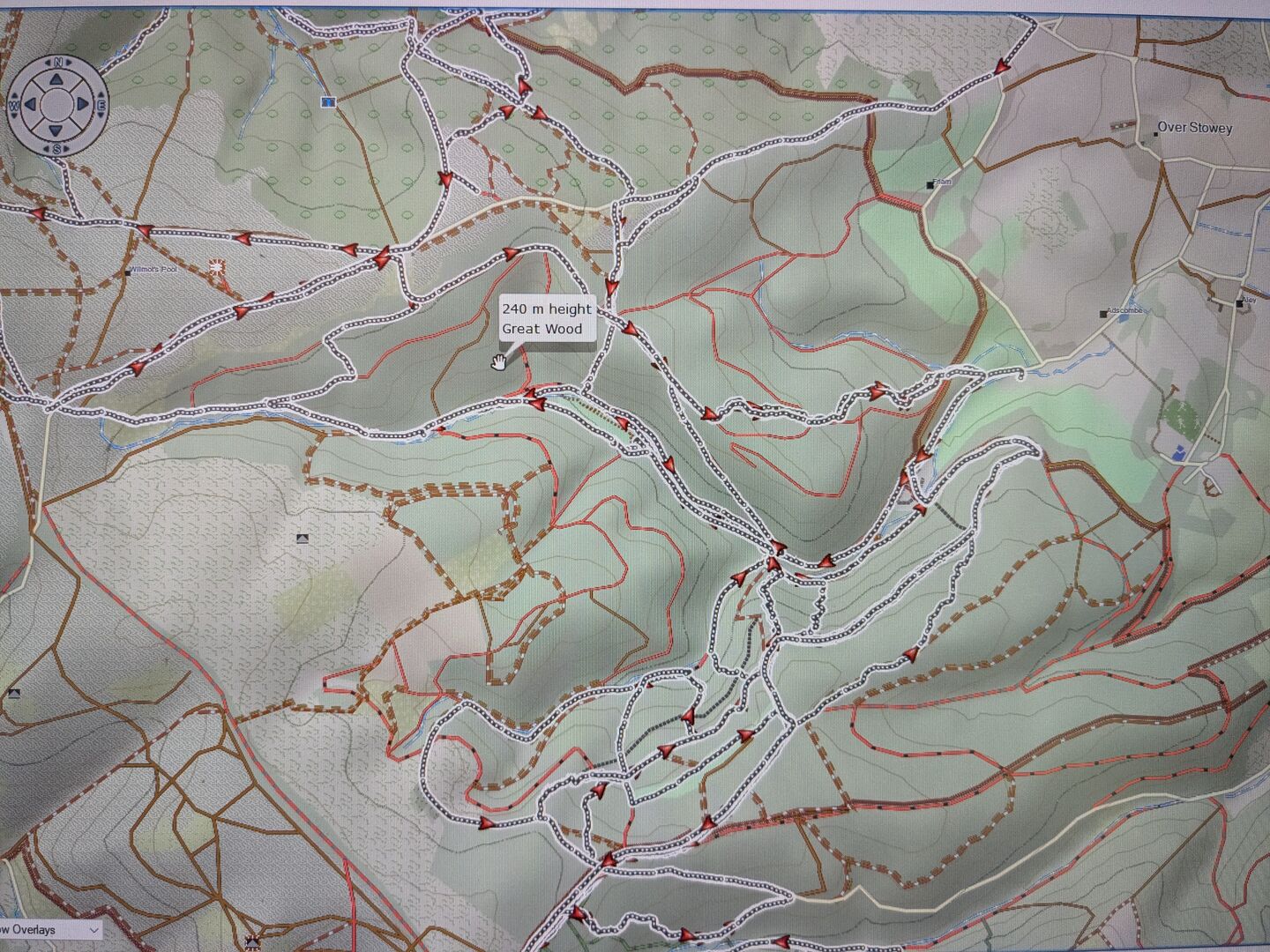

Question to those who kindly responded before, @jonba, @leffeboy, @paul_m, have you found a way of displaying the direction of tracks/routes on the device, when you have them just displayed on the map without navigating?
See below pic of my Oregon with a couple of tracks displayed that I was taking for inspiration.  I was joining from the west, and it would have been great to have direction arrows as per the basecamp screenshot, which I had on my phone, but figuring out directions at crossing points involved quite a bit of squinting back and forth, zooming in and out.
Cheers for any help!
Posted : 28/04/2026 11:14 am
Posts: 6716
My 530 has little arrows.
Back in the day I did two things on my 800 which did not have arrows.
I used a TCX file and course points. Then you could put turn left/right in the instructions.
The other low tech option was to print the route and draw on it. Worked for MTB where I was looking for downhills and crisps crossing a forest.
Posted : 28/04/2026 12:15 pm
