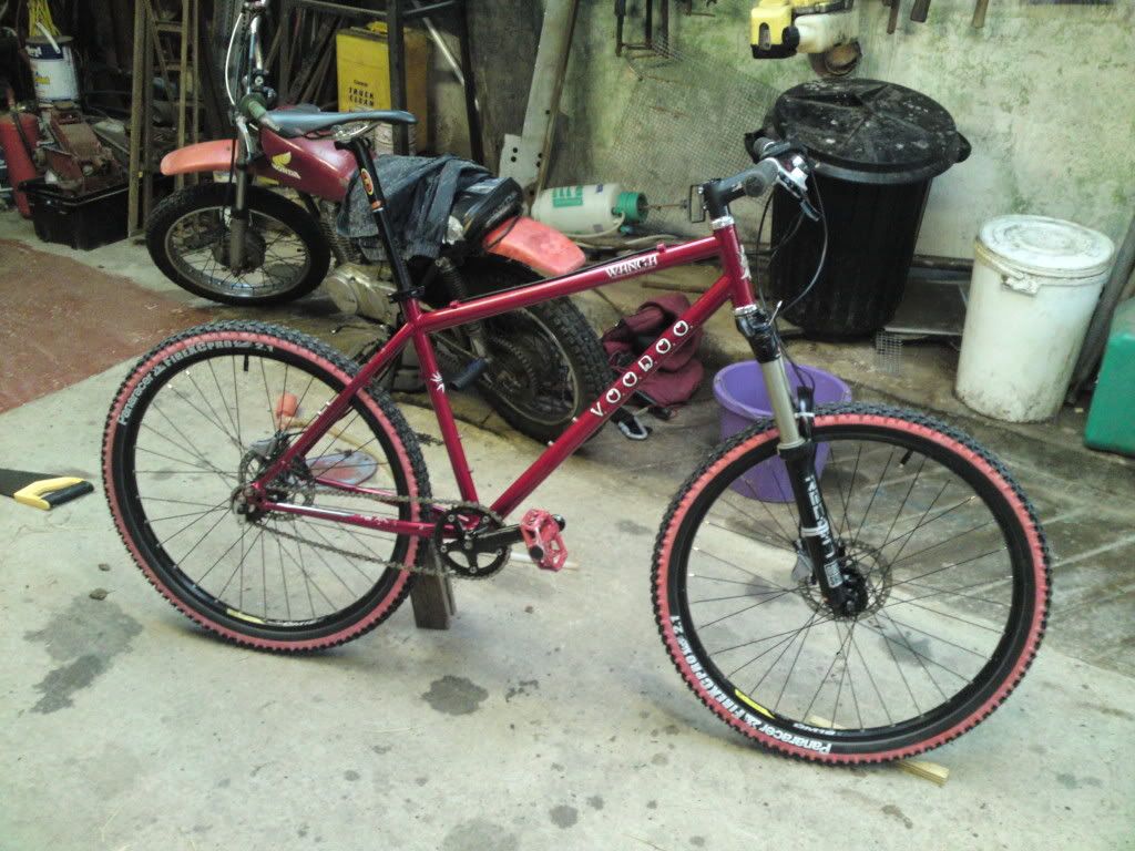

 taka
rocketdog ive just built mine up exactly like that but without the saddle or grips 😛
ohand i replaced the G with a K now its a voodoo ****a :mrgreen:

Posts: 188
You might find they add a bit of comfort on a long ride.
