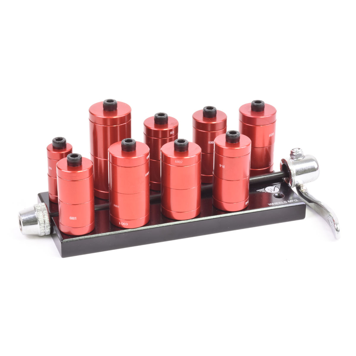

My one is pretty much like this
bearing tool
I can't recall exactly where i got it, so will google some posts of my own and see.
edit.
https://wheelsmfg.com/presses-tools/small-sealed-bearing-press.html
Wasn't as expensive as that though. Obviously i'll use a small piece of threaded bar for clearance instead of the QR they use for doing a wheel hub.

I've got the cheaper Wheels MFG bearing tool (about £70 for the tool and the drifts from Amazon) mine doesn't remove bearings though, only install them? I think the RRP one does, but I can't see how it would work on any of my bearings on my Intense, most of them are blind or semi-blind at lease.
