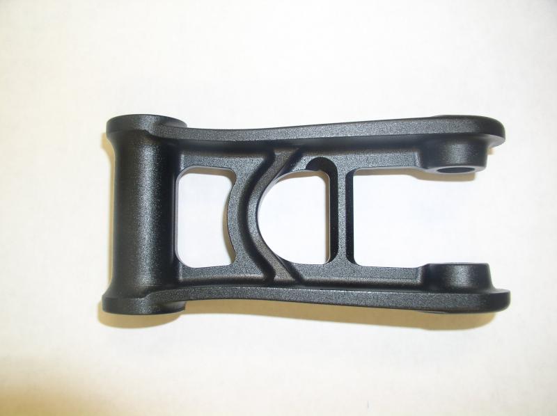

Loco - do you happen to know if the dueler will fit a 07/08 iron horse sunday without fouling the link?
and do you get a choice of spring rate with the Ti spring?
Posted : 29/10/2010 11:57 am
 LoCo
I'm pretty sure that it will fit, I'm going to go and double check later this afternoon, as I friend has one down the road 🙂
And yes I have some other spring rates in.
Posted : 29/10/2010 12:21 pm

 LoCo
GW, just checked the Dueler for clearance in the Sunday frame, it won't fit just a bit too tight I'm afraid.
Posted : 30/10/2010 10:58 am
 GW
ta for checking tho
Posted : 30/10/2010 7:37 pm
 LoCo
The clearance in that frame is pretty tight, it almost fitted but the adjusters would foul when the shock bottomed out.
I can always custom tune your current shock to get it working better 😀
Posted : 30/10/2010 8:13 pm
 GW
is it just the DW link that fouls it?
if so, how much do you reckon I'd need to file off for it to clear?
Posted : 30/10/2010 9:48 pm
 LoCo
With the shock mounted with the reservoir at the bottom facing backwards, it was the high and low speed compression adjusters that were going to hit the first stay that runs across the link.
I don't really want to recommend any grinding as it's quite a small stay and think it would affect the strength of the link adversly.
Posted : 30/10/2010 9:56 pm
