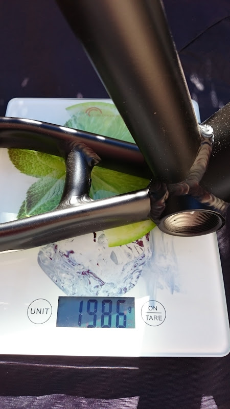

Last week I couldn't resist the MSC Mercury frames in the sale at probikeshop - 100 euros, the right size for one of my kids and with the same BB and seat tube as my old Rockhopper
Arrived quickly in a non-squished box
No fancy colours here
Bit heavier than expected (on kitchen scales), but given the stuff I'm putting on it that's not a big deal
