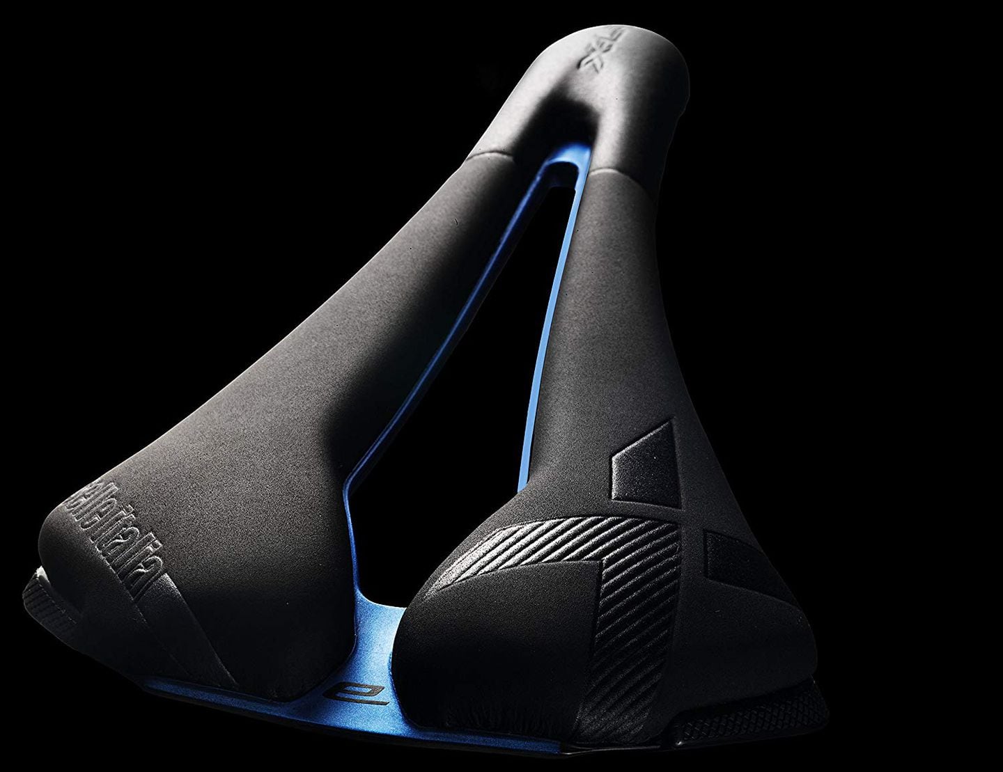

Posts: 12661
As long as you have an e-bike specific saddle, you'll be fine.
https://www.cyclevolta.com/story/ebike-components/saddles-designed-for-electric-mountain-bikes/
Posted : 16/02/2023 12:23 pm
