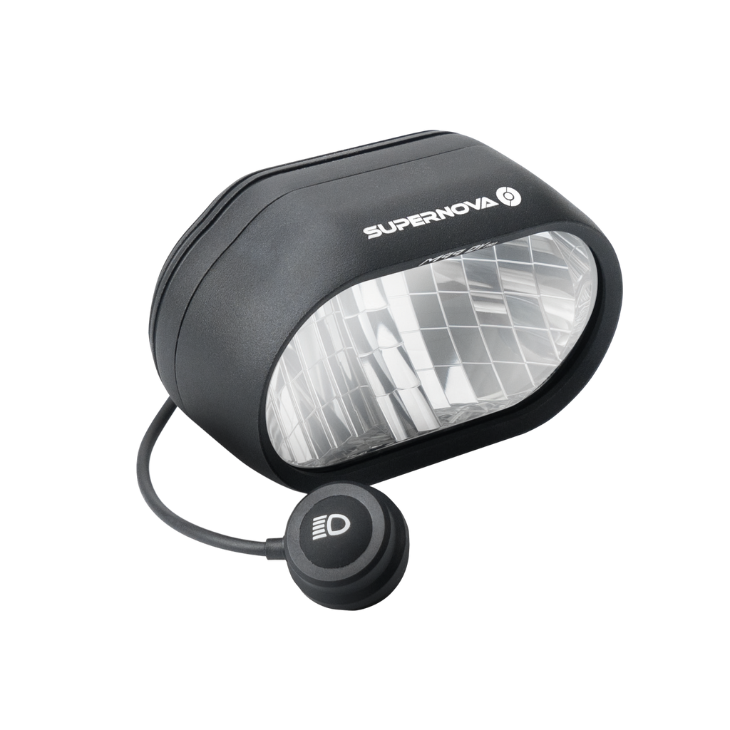

Only ask as road vs offroad makes a difference in terms of choosing a headlight - the STVZO (B&M, Son, some supernova etc) is that the hard cut off is great for road, but not so great offroad, as the hard cut off does not illuminate low branches etc. (ask me how I know..)
Supanova do a dip/main beam STVZO light which looks like might be good for road and off:
https://supernova-lights.com/en-eu/products/m99-dy-pro
