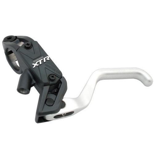

Posts: 91205
I mean I don't have a lever bleed port. They are old levers.
[img] http://media.chainreactioncycles.com/is/image/ChainReactionCycles/prod17135_NC_NE_01?wid=500&hei=505 [/img]
Posted : 17/05/2017 2:42 pm
Posts: 9
Molgrips, just level the lever, undo the two phillips screws and remove the cover and rubber expansion doofer underneath the cover.
Then
One syringe of fluid from bottom to top
Reinstall rubber doofer and cover and return the lever to its normal position.
(If you have a bite point adjustment screw on the lever wind it all the way out first)
Posted : 17/05/2017 3:48 pm
Posts: 91205
That's what I was planning to do - cheers.
