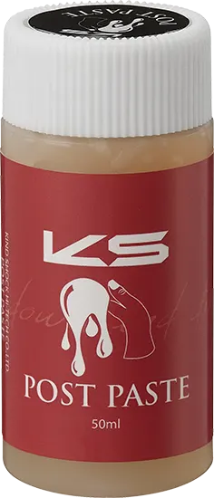

If it's not that heinous, [url= http://kssuspension.com/product/post-paste/ ]this stuff [/url]seems to be worth regular use.
