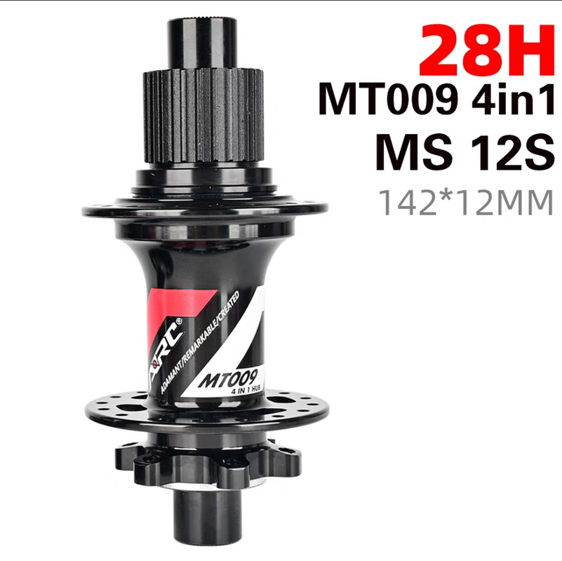

So, and this is whey I'm wondering if this is possible, the weird thing is that the hub comes in 142*12 width with MS freehub and says 12spd
[url= https://i.postimg.cc/GmX9NRVZ/Screenshot-2022-08-05-15-36-45-78-090d9ae461b065ca11c329abb9cd0d70.jp g" target="_blank">https://i.postimg.cc/GmX9NRVZ/Screenshot-2022-08-05-15-36-45-78-090d9ae461b065ca11c329abb9cd0d70.jp g"/> [/img][/url]
It says 28h and my hubs are 32h.
Could it be, that the change is on the disc side? There's a huge cap and gap that side.

148 hubs differ from 142 in the hub shell. You can bodge a 142 to 148 with a longer NDS endcap and a re-dish, as it moves the Rotor inboard which can be spaced back out to compensate. Going the other way leaves you with nowhere to go in terms of correcting the rotor position.
The 2 hubs pictured will have different hub shell widths.

Okay. Been talking to the shop that sold me the wheels. That has the aftermarket kits, and that sale for the 142*12 MS 28h rear hub. The guy says I can't reuse my wheel (whilst avoiding engaging with me on the freaky hub they apparently sell)
I have to buy a new wheel it seems. And doubt I'm going to be able to use my stored cassettes.

It'll depend on the hub, some hubs do exactly as you suggest adding wider end caps to make the same hub body boost, some the boostyness is achieved with a wider hub body.
Googling your hubs it looks like they're probably the latter but the details I can find are sparse and on Ali express.

Yeah, even the shop says no, although that strange listing picture I showed above suggesting 142*12 with MS freehub.
Looking around, there is another ARC hub that does 28h (MT046?) . Maybe they got the listing confused with that
